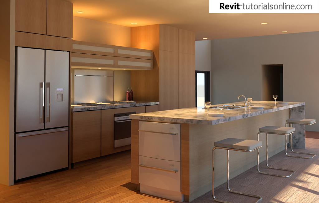

On a side note, my old laptop, which was a dual core 2.0gig with 3gig of ram and a 256 video card [Cheap Option], rendered the below image without any troubles.. it did take 100 hours though. haha.. good times..
