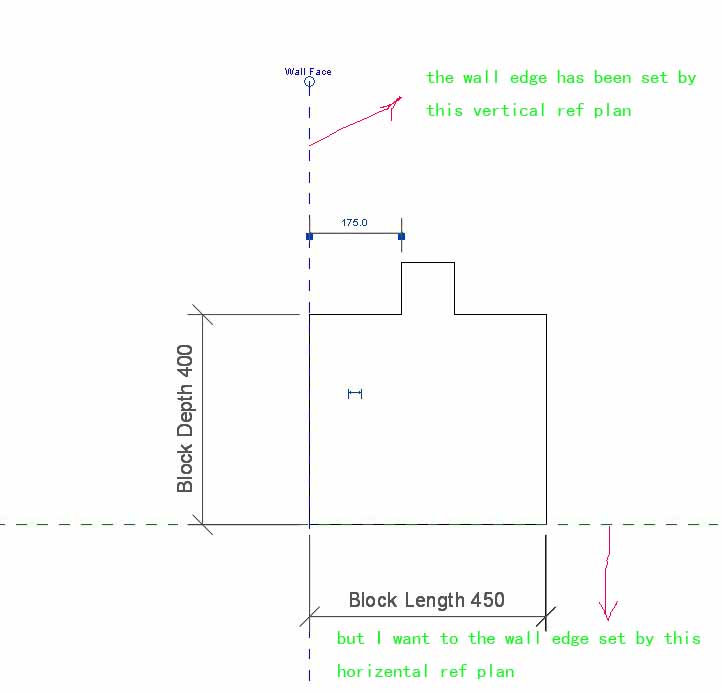

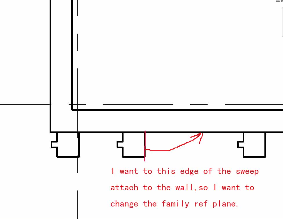

look, my sweep family,  the vertical ref plane has been defined as wall face, so when I upload this sweep to project file, the left of the sweep will attach to the wall, but actully I want to the horizontal ref plane to be defined as wall face. how to change it, also I  need to know how to difine exterior and interior for the ref plane. plus this sweeps was modified from a alreay made sweep by me, so the fucntion of ref planes has already been set.
 thanks!

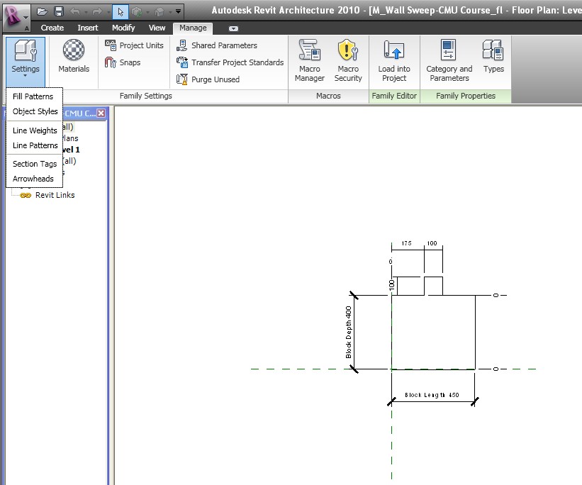

sorry, I didn't find the    Just turn off "always vertical" in the family's settings  as you said
also I have attached my frofile family.

Its simple as ... rotating the profile 90 º, reasign dimensions and reload.
