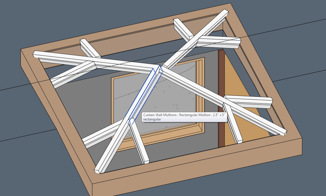

Ran into a rather comfusing issue when creating my Skylight.  Rather, roof turned to sloped glazing, the mullions are picking a finish edge that is angled, making the mullions look terrible.  Is there a proper way to replicate straight mullions?  Perhaps create a specific family?
Or is there a better way in create such a skylight?
Attached image to show what the mullions are doing.
Thanks!
Matt

It seems you will be better off with a roof hosted skylight family. with a pyramid shape.
check to see if Revit city has one already
HTH

Yeah, I suppose, but I really need to be able to add some mullions, like the ones on each corner.  Perhaps I'll just make a family instead.
