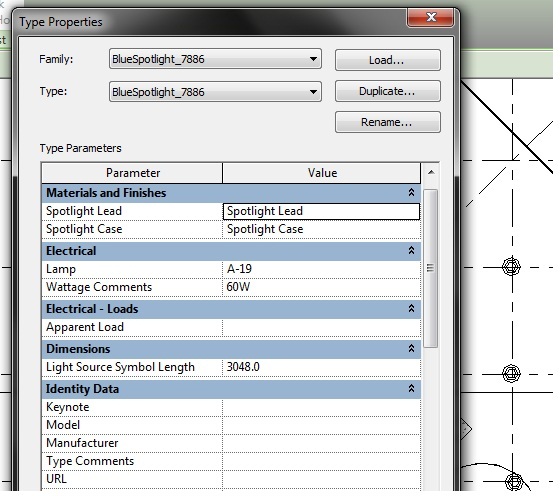

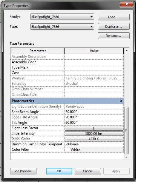

Hello everyone, I'm using revit architecture 2011. I have a problem with lighting fixtures that I put in my ceiling + wall. I have checked the options and everything is how it should be - wattage comments, electrical type etc. But everytime I try to run interior artificial lighting only they dont seem to be working. Though the lighting fixtures I use on the desk does work. Anyone can inlight me please, I would appreciate it!
Thanks in advace,
Ram

check the location of the light source in the family. It may be behind solid geometry and can't shine through.

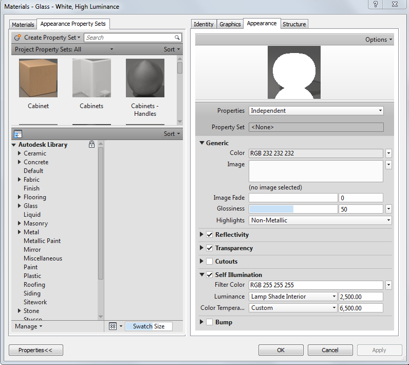

i am having a problem with my canned lighting in my ceiling, the light will shine through and show up on the floor but when i render the view looking up at the light i do not see any light coming from the light itself, how do i get the light bulb to show up in the light, i like the way the light looks on the ground, but it looks very funny when you look up at the light and you do not see any light coming out of the fixture, can anyone help??

Your "light bulb" needs to have a glow property set.
Tue, Jan 29, 2013 at 1:58:09 PM | Lighting fixture problems
nate6923
Joined: Fri, Aug 24, 2012
5 Posts
where do i do that at
Tue, Jan 29, 2013 at 2:04:36 PM | Lighting fixture problems
Here
But it needs to be the material you assigned in your family.
Edited on: Tue, Jan 29, 2013 at 2:05:49 PM

Maybe this helps:
try to set the intensity of the light to a really high value (1.000.000 lm)
