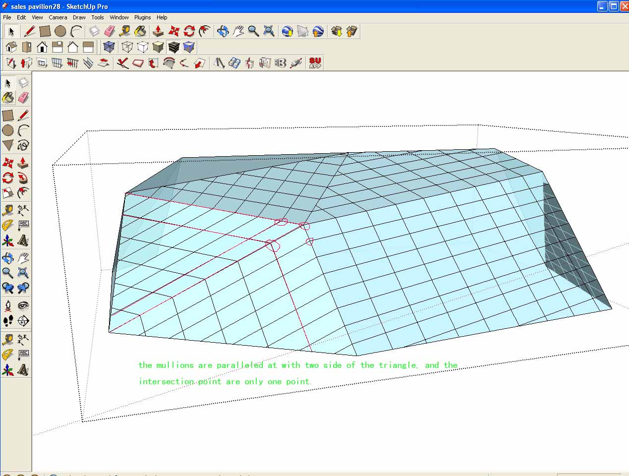

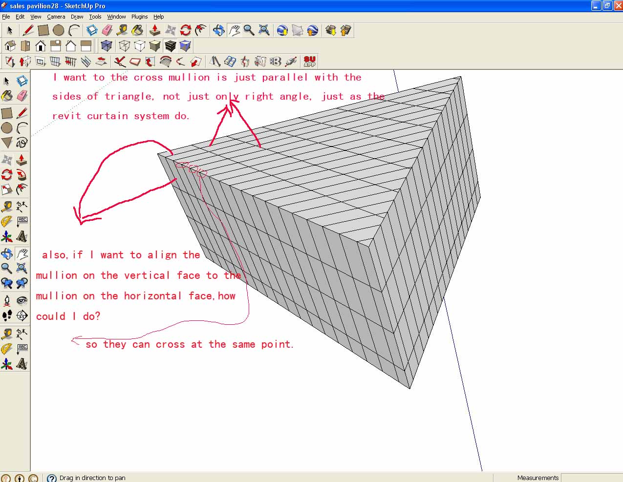

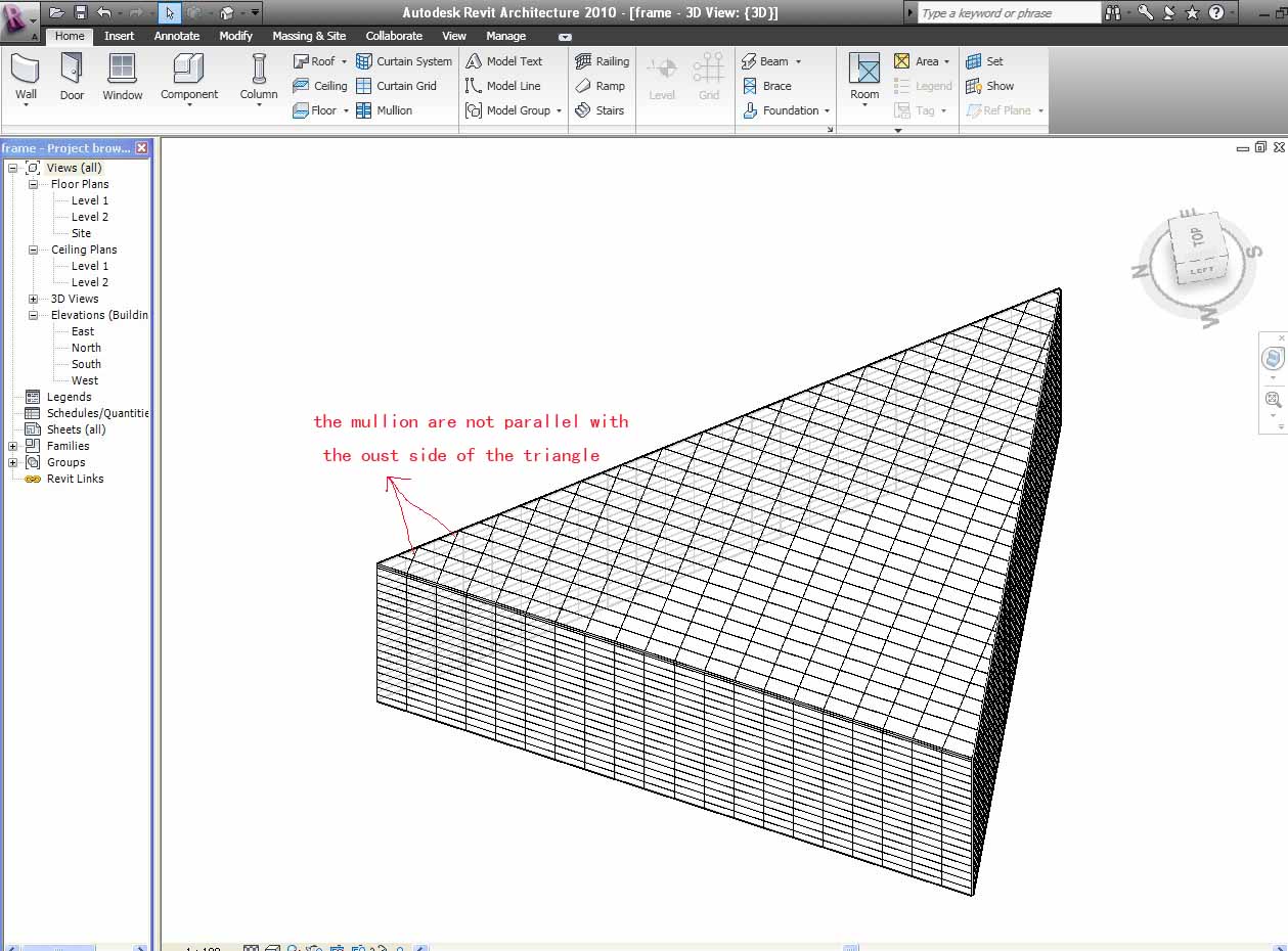

I want to make a curtain, but the angle is not righle angle, I want the cross mullions just paralleled with the out sides of the triangle on the horizontal face, also I want to align the vertical mullion on the vertical face align with the end of the horizontal mullions.how to make the curtain system? see my picture5,3.   thank you!

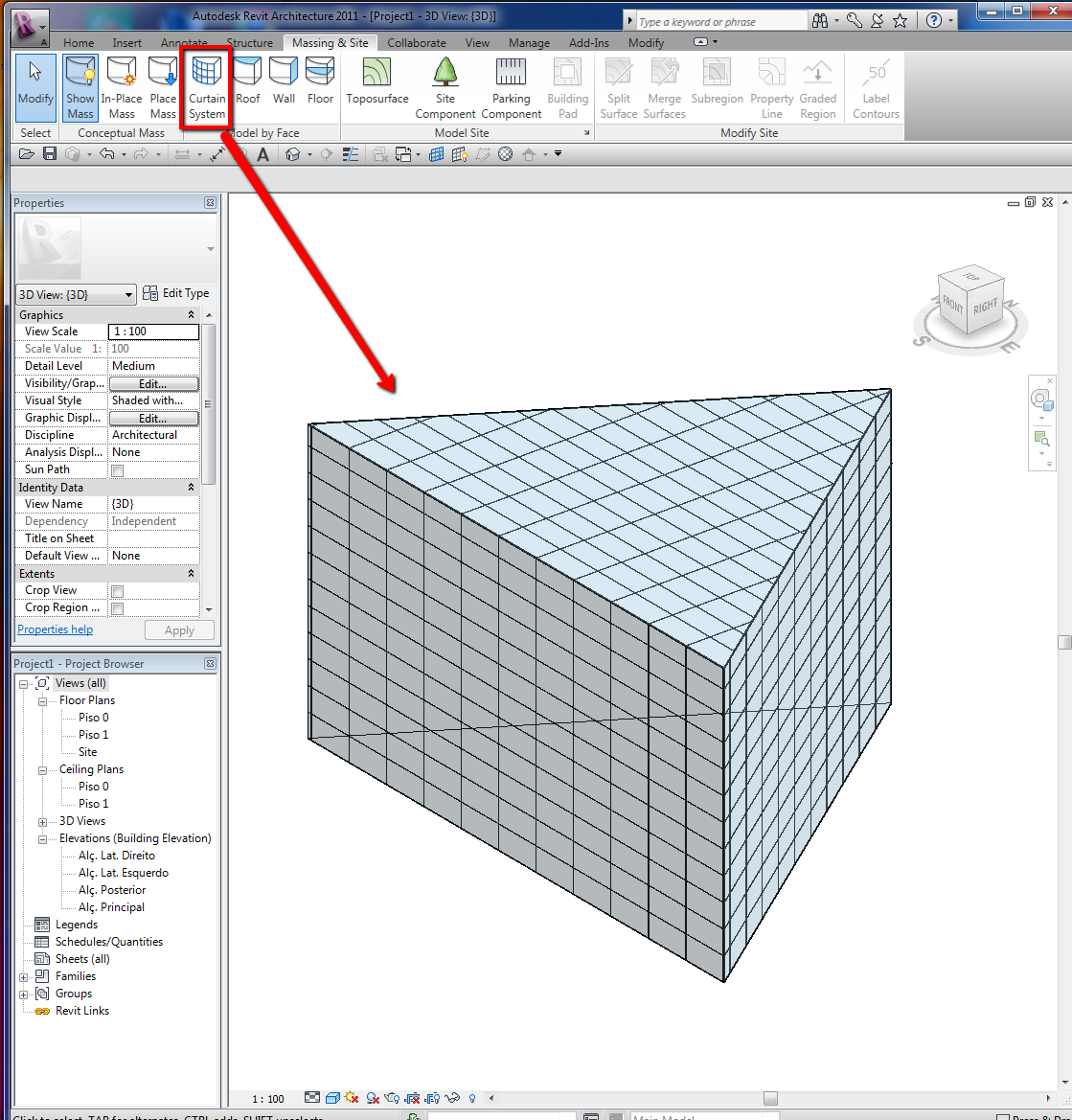

Did you try with "Curtain System by face"?

the picture shows what I mean, I want both the mullions of  two sides  are paralleled with the outside of the triganle, not just one sides of the mullions,  and the two sides of the mullion do not deed to perpendicular to each other.  is there some way to make this? thank you.
