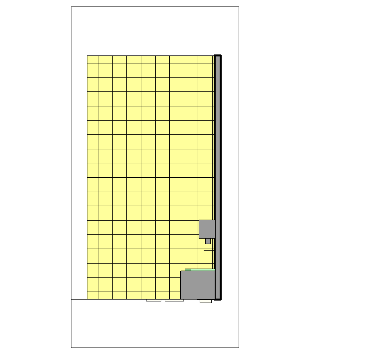

Is there a way to make a pattern, like a 60 x 60 crosshatch pattern on a wall that needs to be yellow on my sheet n views?
I mean, can we mix a filled color + patterns on walls or other revit elements.
I just cannot do it and became thin on new ideas to solve this with some simple and low poly method...

Mmm, But how do you do a yellow wall with a 60x60 model crosshatch pattern on a hidden line view?
I had a curtain wall with yellow panels already done, but I want to change it to a simple wall with this properties because I think it´s a better solution for my project, it's easier to modify and I prefer not to use curtains on this case...
Thanks for all your replies.

Thu, Mar 31, 2011 at 5:58:07 PM | Wall patterns?
mcantwell
mcantwell Avatar
Joined: Thu, Aug 24, 2006
86 Posts
5 Stars: 1 Votes
vhugomg
I don't think there is a way to have what you want.
Pattern and colour options in hidden line view mode
option 1
Set grid pattern (say vertical) and colour (green)
Output - green stripes on white wall
Option 2
Set pattern to solid fill and clolour to green
Output - green solid colour
Solid colour and pattern on wall are mutually exclusive in hidden line view. One or the other only.

At least I confirmed what I believed from the beginning: It´s not possible to make a pattern with and a fill color on a wall at the same time.
I think it should.

LOL, now I'm confused, I see what you are saying mcantwell... I used custom patterns, which I made myself, so in order to get the 60x60 crosshatch, you might have to make a pattern which shades the squares...  As mcantwell pointed out, whatever is normally black, is what becomes whatever color you set it to.  Thus, if you want say white lines between the yellow tiles, then you have to make a pattern which shades each tile (currently, the patterns shade the grout, if you will).

the only way would be to apply a solid color to the surface and go in and draw the pattern with model lines. then you have to hide the model lines in views you dont want to have it show.
