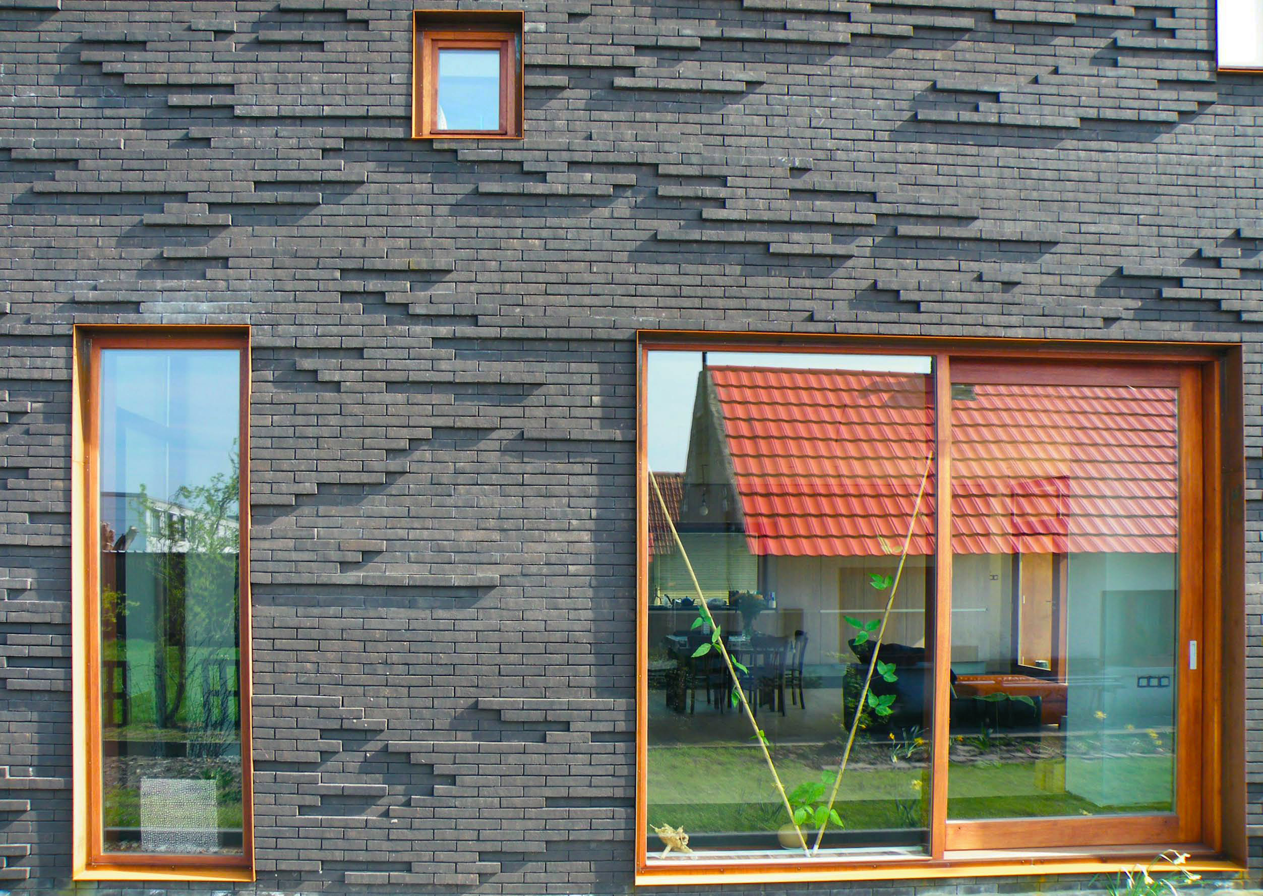

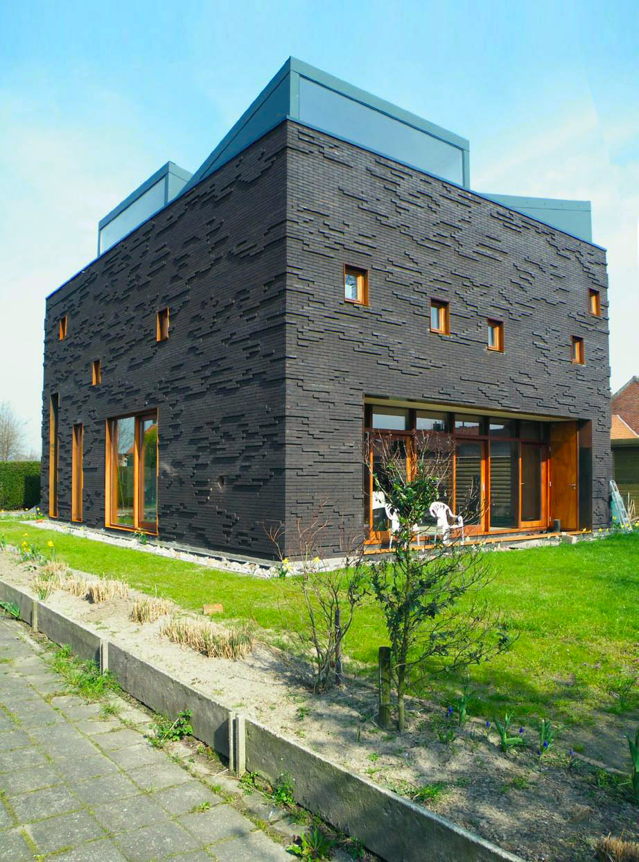

hi, I'm fairly new with Revit ( 3-4 months) and would like to create a wall that has a brick pattern on the exterieur similair to the one in the attached picture.

this will be a problem.
You could try is with a reveal but it will be much work.
Edited on: Thu, Mar 31, 2011 at 7:43:29 AM
Thu, Mar 31, 2011 at 8:29:36 AM | Brick patteren in wall
The easiest way to do this would be to add either an in-place build-out to your wall face onr an in-place void that cuts it back.
I would do the void.
Define your wall as thick as the thickest part.  Then in elevation, create in-place void families for each elevation... wall category that cut the wall back.  Do the whole pattern for each wall face as one sketch.  If your good at this, you could copy the sketch to clip-board and use portions of same sketch for each wall.

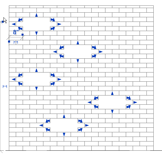

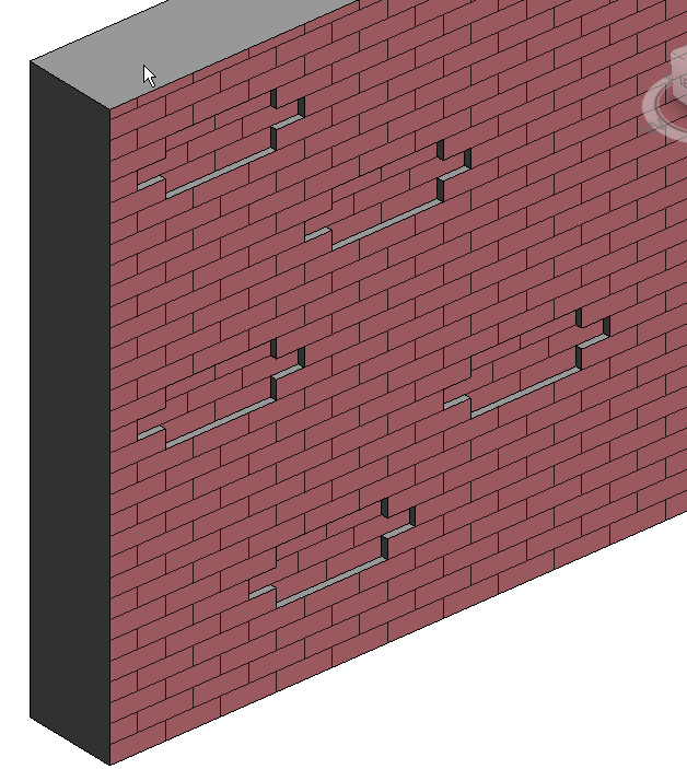

Thu, Mar 31, 2011 at 9:57:26 AM | Brick patteren in wall
See attached.
  1. Create your wall.
  2. Add a reference plane in plan at wall face and name it - like south wall
  3. Home/Component/Model in place
  4. Name it like south wall void
  5. Select Void extrusion
  6. Pick your named plane
  7. Sketch the void - attched view shows you can trace over the elevation... I made one and copied to several places - you might have several different shapes to randomize yours.
  8. Set the thickness of void ... negative number if you are on wall face.
  9. Before you finish the family, pick that it cuts your wall.   Note that if your voids go over the ends of the wall, you will have to pick joining end walls to.
  10. Finish the void.
  11. You will have to paint the finish in the void.
For some reson my void did not end up on wall and I got an error message that it did not cut inteded target.  Don't delete the void.  Find it in plan and move it to the face of wall.

Bit late, but Its all done, thanks for the help, helped me out a great deal !
