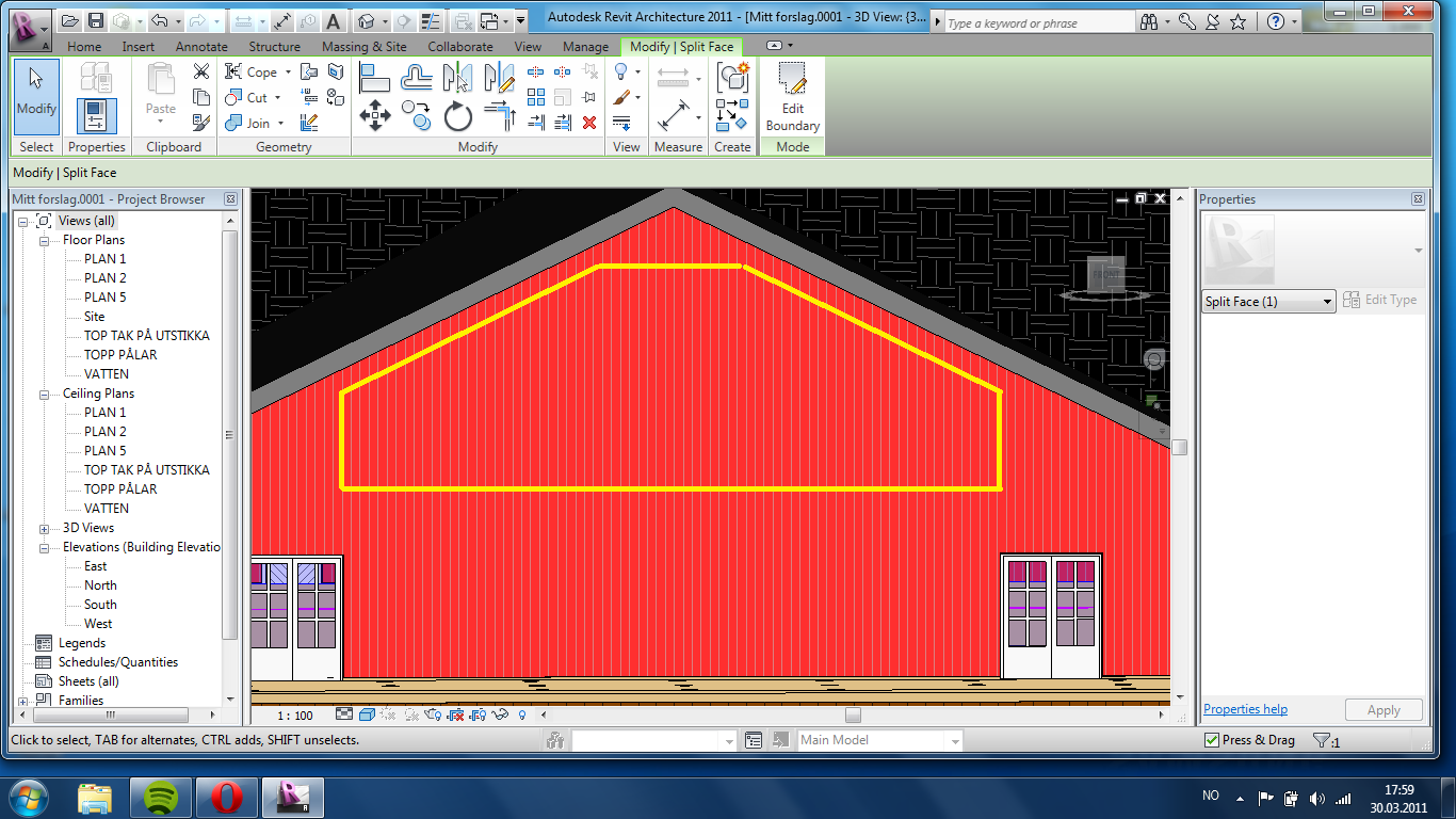

This is probably a stupid question, but I haven't been able to find a solution.
I was wondering if its possible to make a curtain wall in the area that i market with yellow on the picture?
I have tried to split the wall, but i cant get the same shape.. Is it easier to make a window?

Wed, Mar 30, 2011 at 11:30:25 AM | Curtain wall question!
matthewh75
Joined: Thu, Aug 21, 2008
100 Posts
3 Stars: 3 Votes
Draw your curtain wall on top of the existing wall, adjust the height parameters of the curtain wall to suit the max / min heights. 'Cut' Geometry of your red wall to join the curtain wall to it. Use 'Edit Profile' to trim to the correct shape. Voila.
Wed, Mar 30, 2011 at 11:39:55 AM | Curtain wall question!
You don't need to edit profile.  Just check the embed checkbox on the curtainwall and it will embed itself.  Do use edit profile on the Curtainwall if it is not a rectangle.

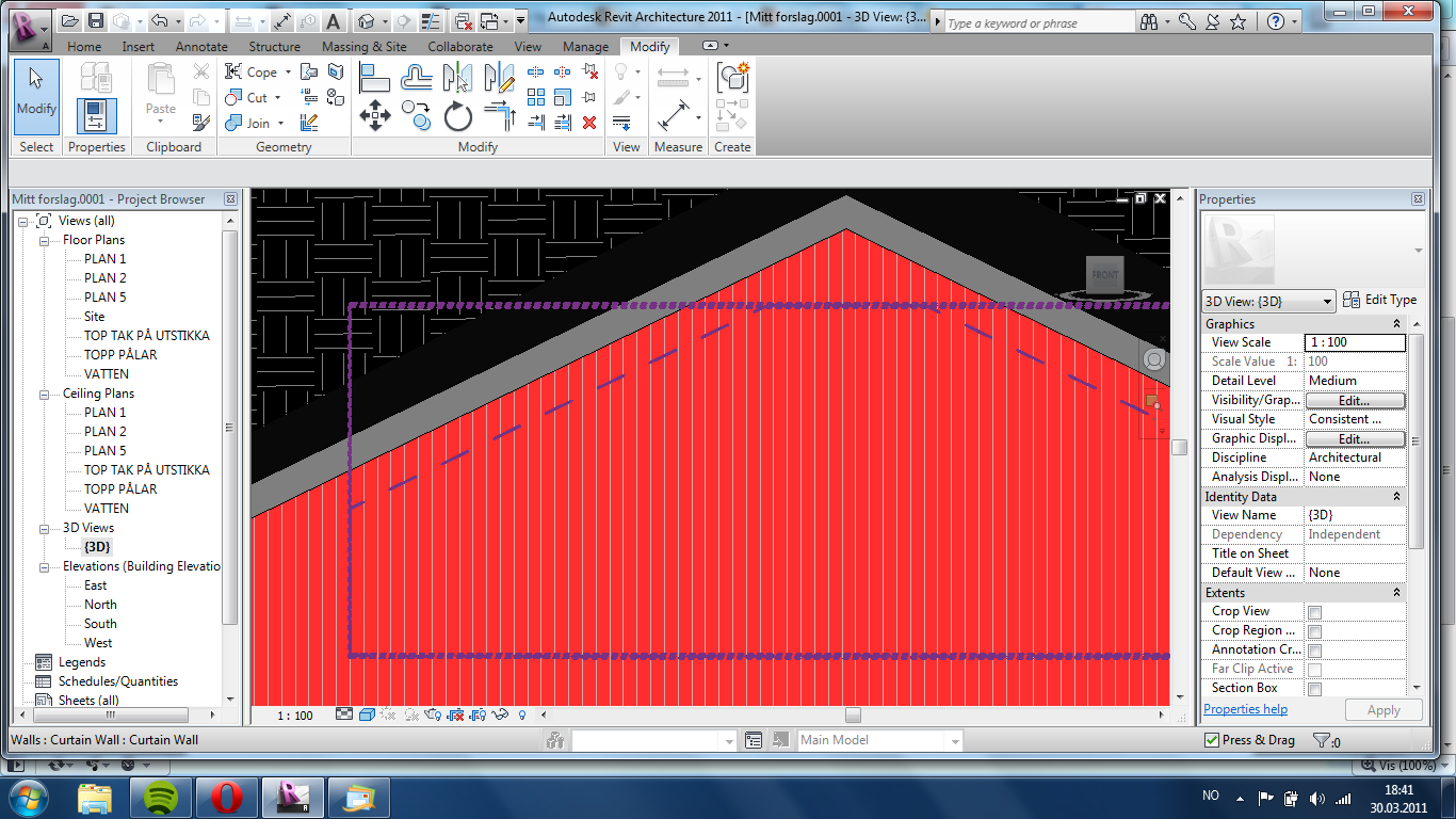

Wed, Mar 30, 2011 at 11:45:58 AM | Curtain wall question!
Bard
Joined: Wed, Feb 16, 2011
4 Posts
As you see from this picture, I cant cut of the corners on the curtain wall.
I only get dotted lines and the wall goes outside the red one!!
How do i get this right??
Wed, Mar 30, 2011 at 11:51:58 AM | Curtain wall question!
Bard
4 Posts
I got it now.. Thanks for the help!!

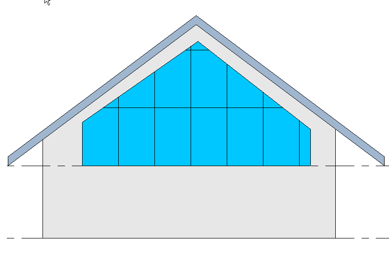

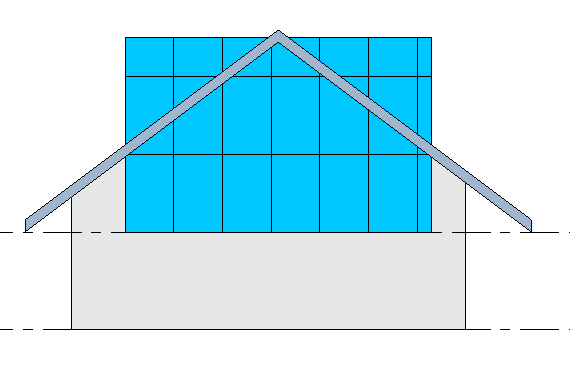

Wed, Mar 30, 2011 at 11:57:27 AM | Curtain wall question!
Look below.....
90343_ScreenHunter02_Mar._30_12.53.gif90343_ScreenHunter05_Mar._30_12.54.gif90343_ScreenHunter06_Mar._30_12.55.gif
