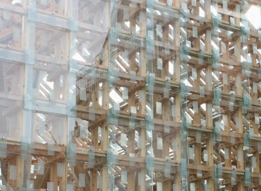

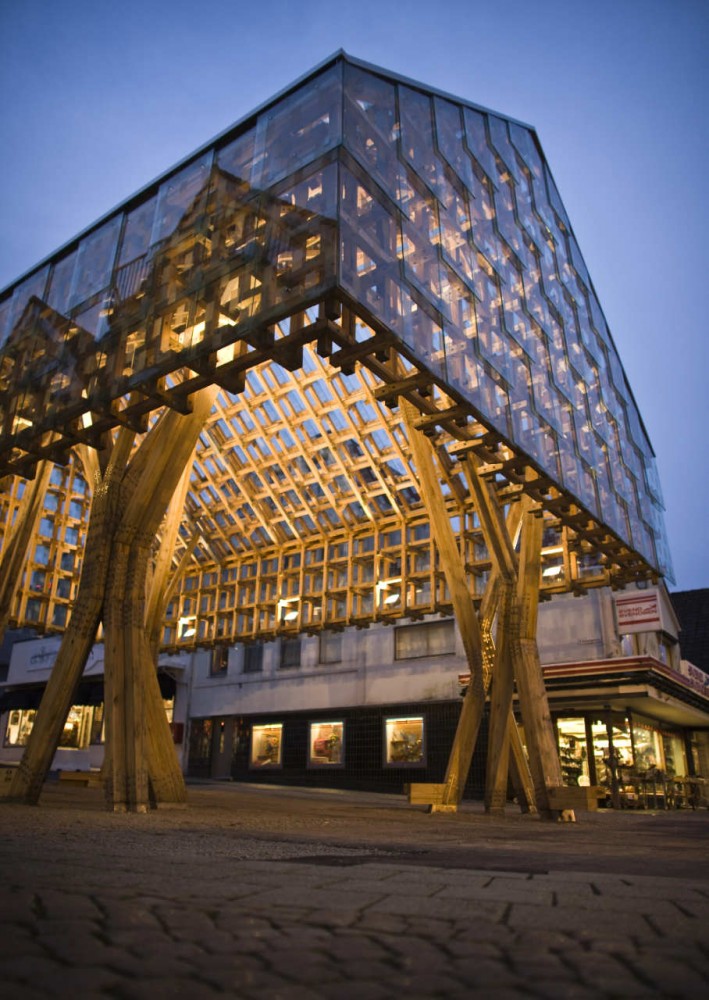

Hello all,
need some help in creating a cascading curtain wall, similar to the attached image,
anyone know how?
Adam

create a cw from scratch, make a reference line from the top constrain. There you can add an angle constrain. Create a extrusion from that , make sure it overhangs the bottom. Go to the exterior or interior view and overhang there too, you can add a parameter ther for that. Then replace the panels you need to overlap, and your done. Hope you understand it :S

You won't be able to achieve this with typical curtain wall (curtain panel) system even you make your own. since the curtain panel cann't follow the ridge slope.
I would say you can try to use curtain panel pattern panel with conceptual mass family to achieve this.
Wed, Mar 30, 2011 at 8:50:55 AM | Cascading Curtain Wall
You will not be able to do this with a CW or using a wall by face.  It appears that these glass panels are shingled as they go up.  I would probably model them as walls with end joins and room boundry turned off or use a special "wall" category family.  That might be better because it could contain those "spacers" that offset the glass as they are shingled.  The family could be type base sized.
