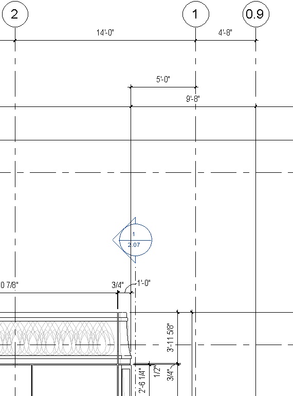

I know there's no true "draworder" in Revit 2010, but is there a way to move annotations behind other annotations.  For example, I've drawn all of my section cuts first, but now my dimension extension lines are on top of the sections and do not mask with the section text.  I want the section on top of the dimension so it will mask the dimension line and keep the section id readable i.e. no line through it.  See attached screenshot.

Only with Detail components & detail lines.  Annotations are drawn last, meaning they should show over everything else, but if its annotation on top of annotation, well, I have no clue how it determines which one is "on Top".

Why dont you fix the dimension to a certain distance?
Select the dimension, go to edit type, under graphics go to "witness line control" parameter , change there to fixed dimension line, change the extension to whatever you need.

It appears that whatever is drawn first is on the bottom.  Anything else drawn after it is on top.  I can modify that one dimension, but it's just one instance where I have the problem.  I was hoping there was some workaround I didn't know about.  Doesn't seem like that is the case...

usually I just move the section cut away from the building more so that it is not so cluttered even up to the level of the grid bubbles

You can also split the section, bend it away like we used to do when drawing by hand...  To do this, click on your section, then on the ribbon, you should see a "Split Segment" command.  Click on this button, then select somewhere close to your section head, it will cause a bend and allow you to choose where to place the section head (if you do it too close to the tail, then it will move the tail end instead...
