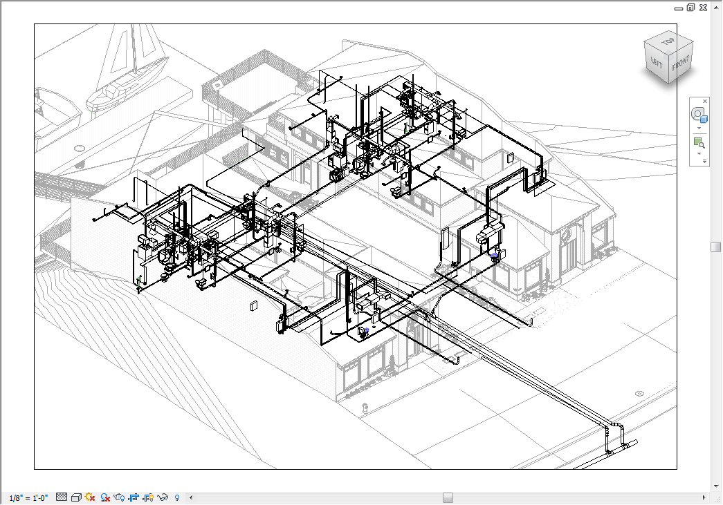

These were made in MEP, on the original Architectural Model.

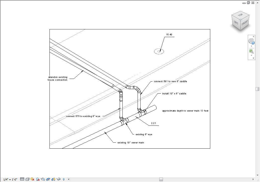

Parametric line based pipe with fall for sewer, stormwater and field drain attached (I hope)
