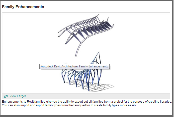

Tue, Mar 22, 2011 at 8:56:36 AM | Extracting families from a file for future use in other files
DeifyMe
Joined: Thu, Oct 7, 2010
64 Posts
4 Stars: 2 Votes
 looks like this will be possible with REVIT 2012
