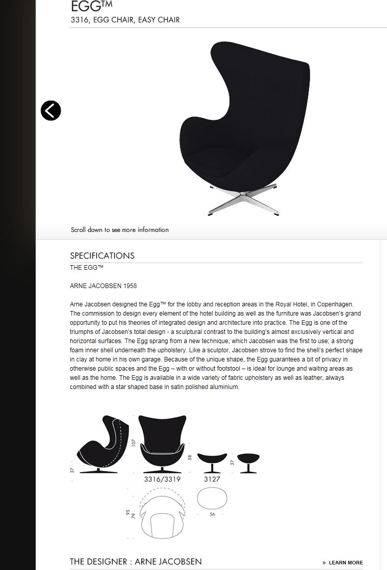

I need the Egg Chair in Revit and I have it in a .3ds file i wanted to know if there is a way to export from Max to revit?  Any other ideas on modeling a complex shape like this?  Thanks

You got an image of that egg chair?
I wouldn't recommend to import any max or sketchup file into revit since Revit doesn't work well with neither of the file type (especially for furniture)
But to answer you question,
first save the file as dwg
then you can do so by create new family, then go to  insert --> import cad and insert
and save
the down side is you can't modify any of the imported geometry
so the best bet is to create it in native revit

is there a tool mabye im not familar with that will make more complex shapes like this chair?

In a native family editor mode, there are a few option you can try to achieve it by using solid and void to create the shape of the chair. (sweep and cut with void OR revole and cut with void)
From my experience, the hardest thing to do is to get the edge round for this chair. other than that, the overall shape is not as hard as you think.
