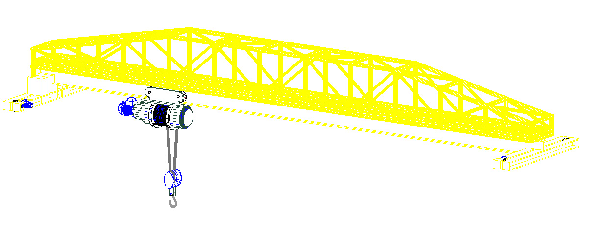

As you can see in the image, the contour lines appear right and they´ve got colours (and materiales) but the faces are white, maybe I´m wrong and with imported object this is not possible.

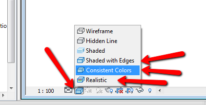

That depends how the model was created and the materials and colors you apply to thosefaces, try to change the "visual style" and check if they change, but if the model is rendering well you have what you need.
Tue, Mar 15, 2011 at 2:44:52 PM | Imported object transparent faces
Did you assign a shading color to those materials?  Manage tab - materials.
