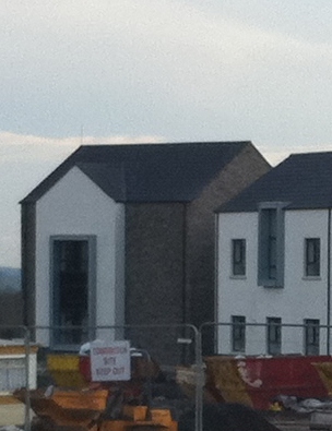

I AM TRYING TO MAKE WINDOW SURROUNDS LIKE THE SILVER ONES IN THE PICTURE ATTACHED, I HAVE TRIED CREATING THEM WITH IN PLACE MASS STARTING WITH THE BOX TEMPLATE AND ALTERING IT, HOWEVER I DONT THINK THIS IS VERY ACCURATE....IS THERE ANY SPECIFIC WAY IN WHICH TO CREATE THEM? I AM USING REVIT ARCHITECTURE 2011...

Did you mean the surround on the left of the image?
Try to create a face based/ wall based family (generic catagory) and use it.
You can use simple extrusion to do it.

Try creating a sweep hosted on the windows opening.  Use this profile
http://revit.autodesk.com/library/archive2009/Library/Revit%20Architecture%202009%20Library/US%20Library/Families/Profiles/Trim-Exterior-Flat.rfa

Christofur84,
Did you mean to use this profile to create a in-place family?
I would think using a loaded family is a better way in this case sinceyou can make it as a parametric family and be able to use it for other projects.
and creating a loaded generic family is quite easy in this case.

Problably would be better for future use....i was just going for the quick fix...model in place...generic model...the sweep becomes somewhat parametric if you change windows sizes

I would suggest that you don't use a mass for elements like this.  For both in-place families and loaded families, you should model the item in the correct category.  If this is a wall element, then you would want to place it in the wall category so that it can be controlled in VG.

I would also model in place.  A sweep in the wall category with "pick 3D edge" to define its path, the path being the wall edge where it's cut by the window.

I ENDED UP DOING IT WITH A REGTANGULAR MASS AROUND THE WINDOW FRAME EXTRUDE IT, THEN OFFSET THE MASS AND EXTRUDED IT AGAIN...WORKED BRILLIANTLY

My only comment is why a mass?  I can never understand why someone would use a mass rather than a true component element assigned by category.  If this should be part of the wall then make it be in the wall category - not mass.
