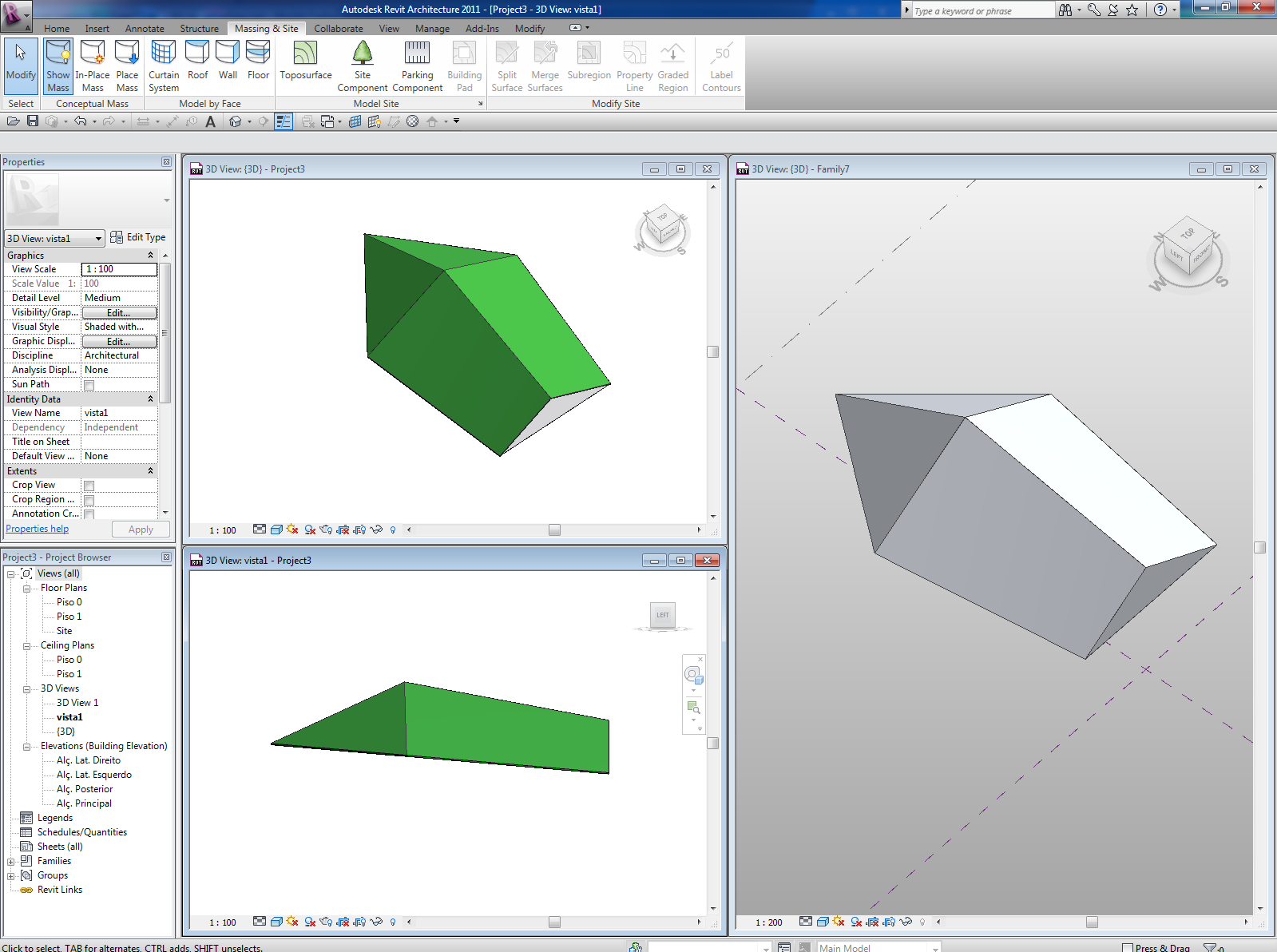

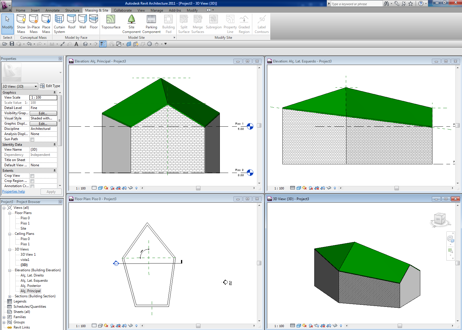

Please see the image.
I have made a flat tilted roof on my little house. But I wish the roof to be like the other one (on the side of the house). This will not tilt, and are laying horizontal on the elevation 3000. The flat tilted roof are tilted from elevation 3000 til 4000.
Any tips, tricks or suggestions on how to replace the flat tilted one with the other?

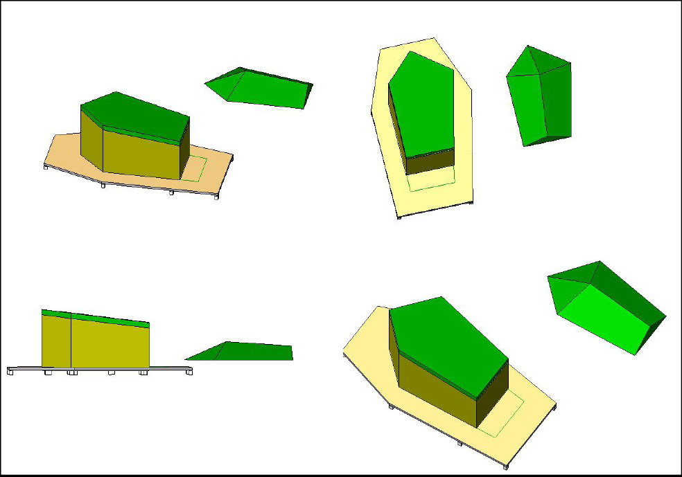

Simple, just create that shape in "Conceptual mass", import to project then apply "Roof by face.
Also, if you have that created already in Sketchup, just import to project and apply the roof by face....

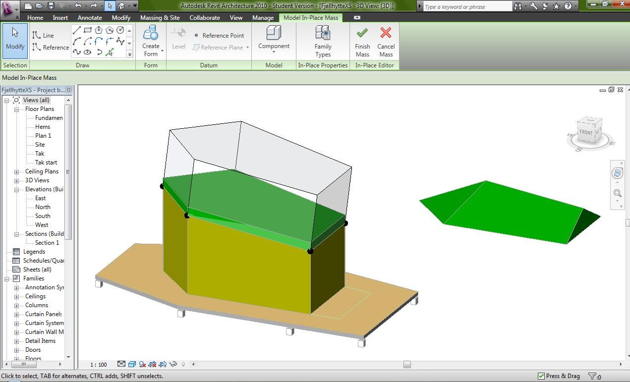

And how to create such shape? I have tried, but get a lot of mixed lines and inaccurate form (curved). I am using 2010 vs, and Model In-Place Mass. I use the flat tilted roof as the base for the new form.

Watch the video: http://screencast.com/t/kELlOTczpFpm

Thank you very much! I now managed to make the roof. The video was very informative =)
