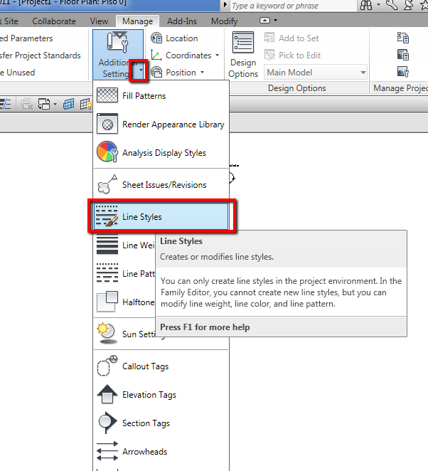

I have been trying to figure out how to add/alter line styles.  I read that you have to go to manage > object styles but where from there?  I do not see lines in there.
Thu, Mar 10, 2011 at 2:17:41 PM | Altering Model and Detail Lines
Joined: Tue, May 22, 2007
5921 Posts
4 Stars: 205 Votes
Here you have...
