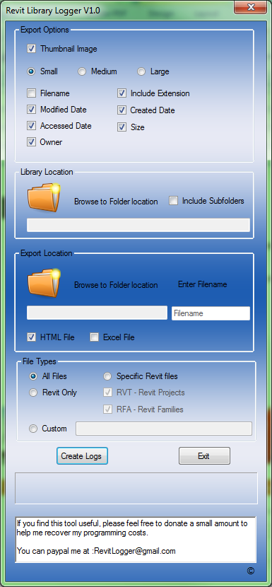

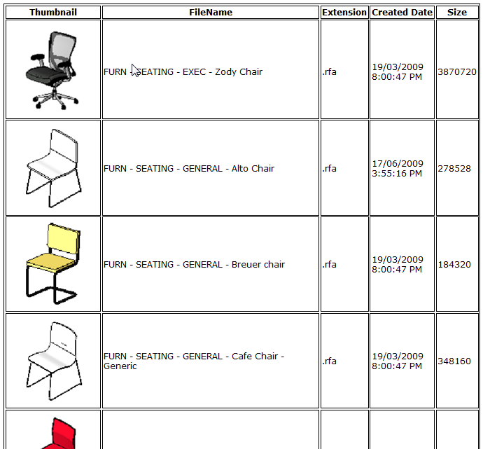

If you have a large Revit Component library, you may want to create a document that lists the families and their details. Here is a link to a free app that I put together that creates a HTML file with images and other information, listing your library components.
I had this app written so that I could quickly document my library, and include it in an office manual. Others may find it useful as well.
The application has been developed and tested on Win7 64Bit / Revit 2011. Im not sure how it will go on other OS / versions.You need to run it on a PC that has Revit installed to get thumbnails.
Hope someone else finds it useful.

Seems like a good idea, so I figured I'd give it a try. It doesn't seem to be working for me though. I point it at our library folder on our server, give it a local path to save the html file, then click Create Logs. It says it's processing the first family in the folder, then hangs and eventually crashes.
Win XPPro 64bit, Revit 2011

Ive had a similar thing happen, when I point it at the root folder on my server. I think there is just too many folders to work through. Selecting a subfolder with less subfolders seems to work. I havnt tried it on XP64 either.
Try it on a subfolder and let me know how you go.

Tried it on a smaller subfolder, still no dice. Hangs on the first family.
