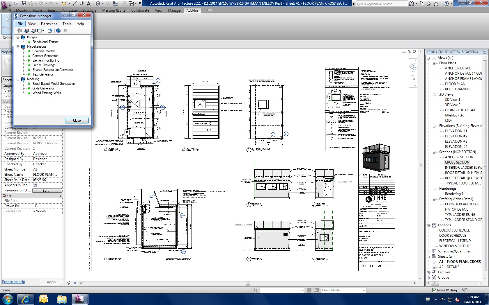

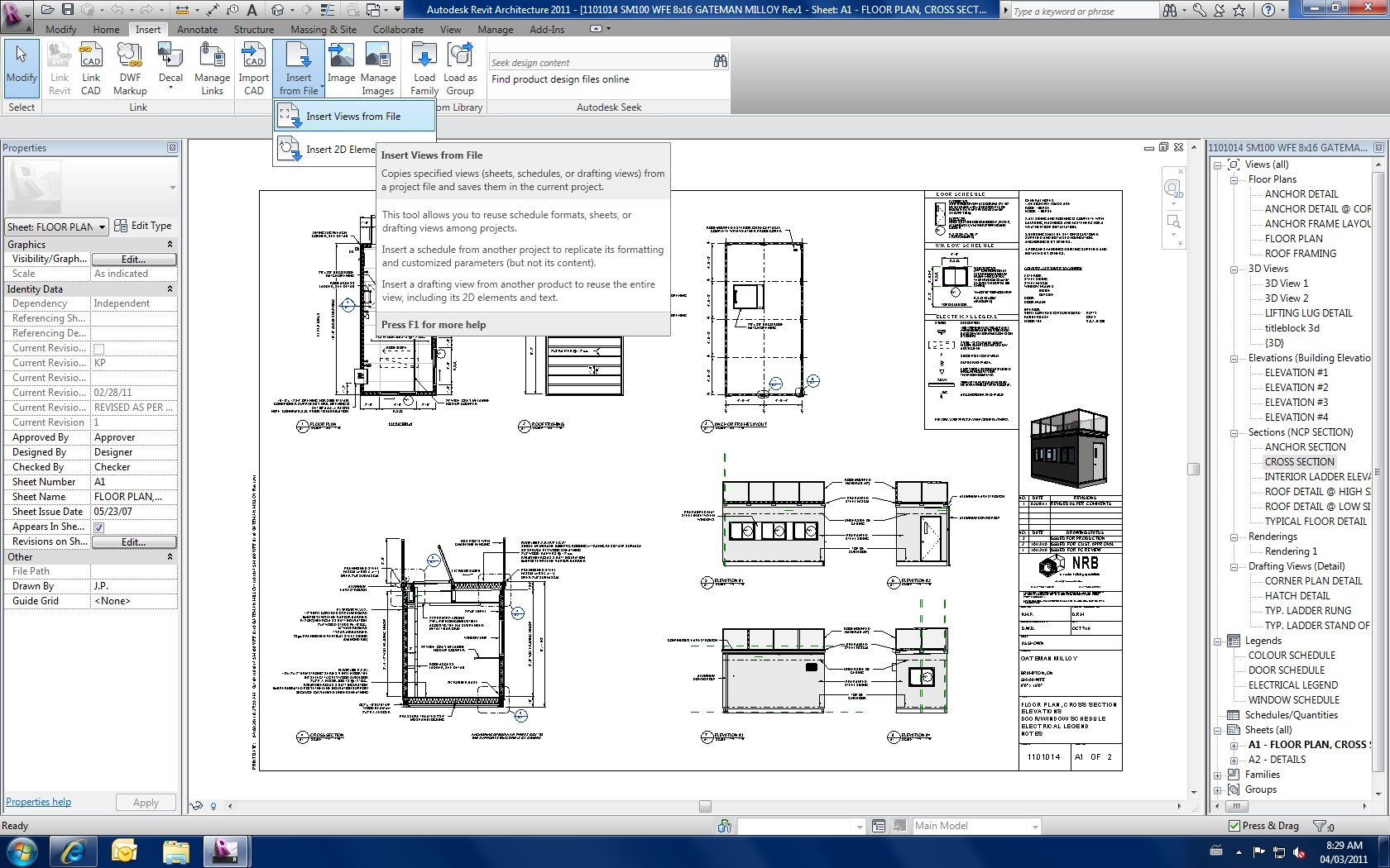

you could use the Freeze drawings add-in to convert it to a drafting view. Then in your new drawing, go to Insert view from File and select the other file, then select only that drafting view.

Thankyou that was exactly what I was after. Worked perfectly
