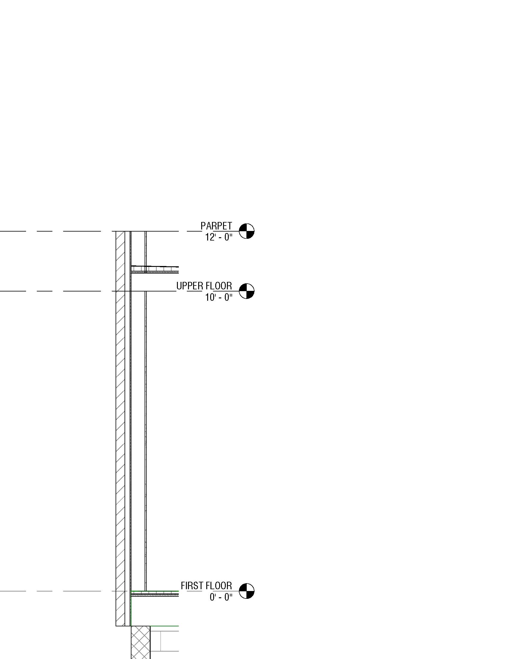

I could use some help here.  My roof and floor finishes interrupt the structure of the wall and joist assemblies.  How do I stop the finish and show a proper section?

Your floor extends to the limits of your floor sketch.  If you want it to go all the way through the wall or if you want the wall to pass the floor, then sketch it accordingly.
