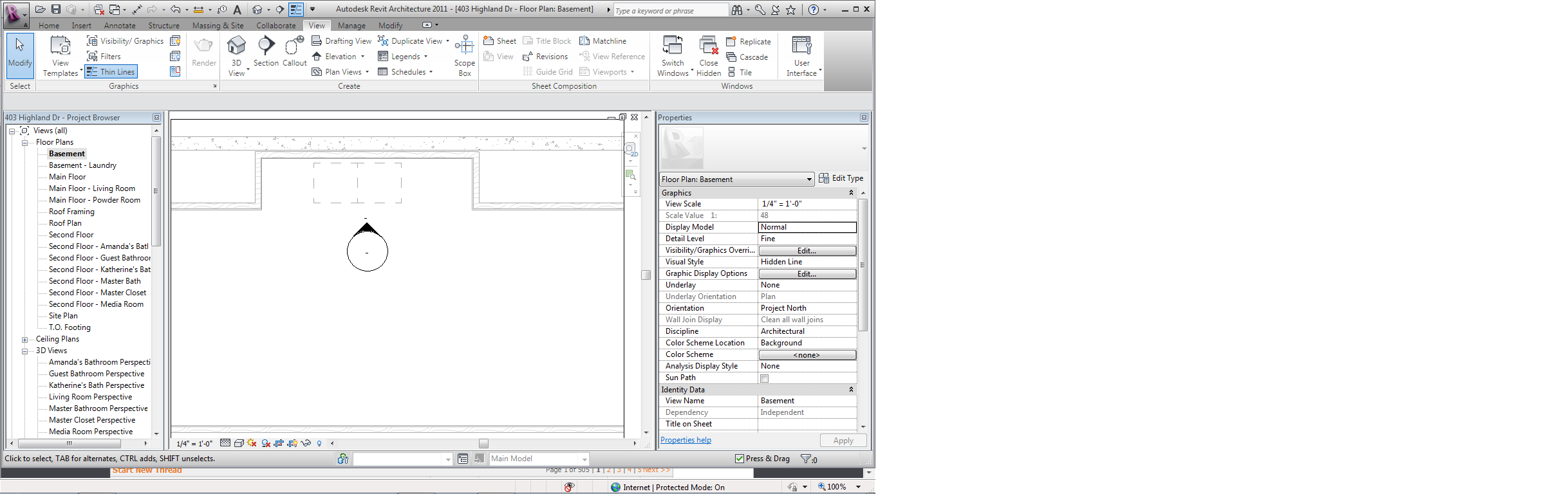

Good morning all,
I'm sure this is a simple fix but I'm stumped how ot do it. I have a basement level that is showing walls and components as halftone even though the settings are "normal" but when I input an interior elevation is diplayed normally!!
It is all new construction (verified with each object), no phasing is used, it is very basic it is just displaying improperly. I'm using Revit Arch 2011.
As usual any help is greatly appreciated. Thank you for your time

Yes, I checked the view range and it is set for that level - Basement - and it is set at 4'-6" (top of walls is set at 7'-4"Winking
Discipline is set to Architectural.
All of the notes, dimensions, elevation tags, section tags, etc are displaying normally - just the walls and components show halftone!
Thank you for the suggestions - might you have any others? :-)

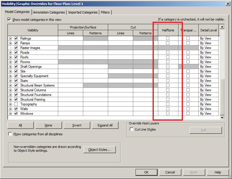

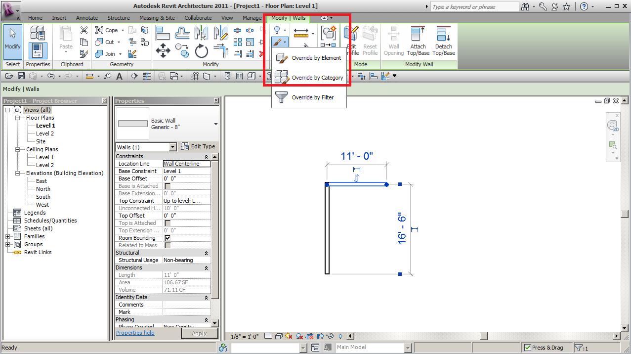

I'd check the visibility graphics overrided and any overrides by category.
See two images attached.
Wed, Mar 2, 2011 at 12:20:05 PM | plan shows as halftone - set to normal
Binnsdrafting
Joined: Fri, Feb 16, 2007
26 Posts
Thank you dgcad - it was the "Halftone" checked in VG. Like I said, probably an easy fix (and I even looked in VG but apparently did not look at the entire screen).
Now the questions is how did those get checked? But the problem is fixed. Thank you again - If you were in the Denver area I'd buy you lunch.
