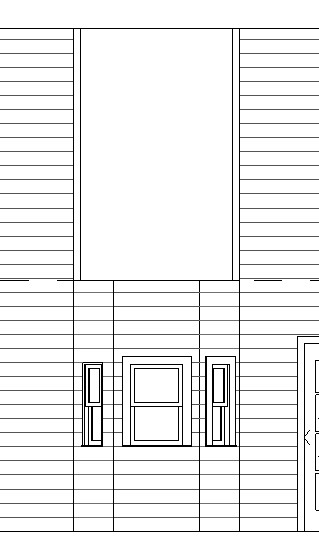

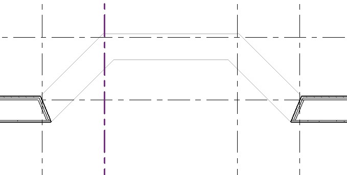

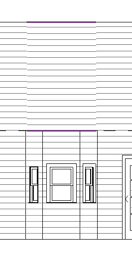

Attached images tell the story better.  It is a residential setting with a kitchen nook on the first floor.  But the second floor, that nook becomes a flat wall.  When create another wall on top of the nook, exterior siding does not align.
What could be the problem and how can I correct that?

Is that a "Model Pattern"? if Yes, did you try the "Align" tool?

I found that the walls that looked mis-aligned on the outside were actually just a tiny bit out of alignment in plan view. I deleted the offending wall, then redrew it, making sure that the  location lines that I was using to draw the wall lined up, then joined the walls. Another time, I also tried using the "align" tool which worked as well, and saved some steps.
This worked for me....  Maybe yours is the same problem?

As you (sroreilly) mentioned, I solved the problem by deleting the wall and redrawing the whole wall.  However, instead of splitting the wall, I created an opening and placed the nook walls there.
Problem solved at this moment.
