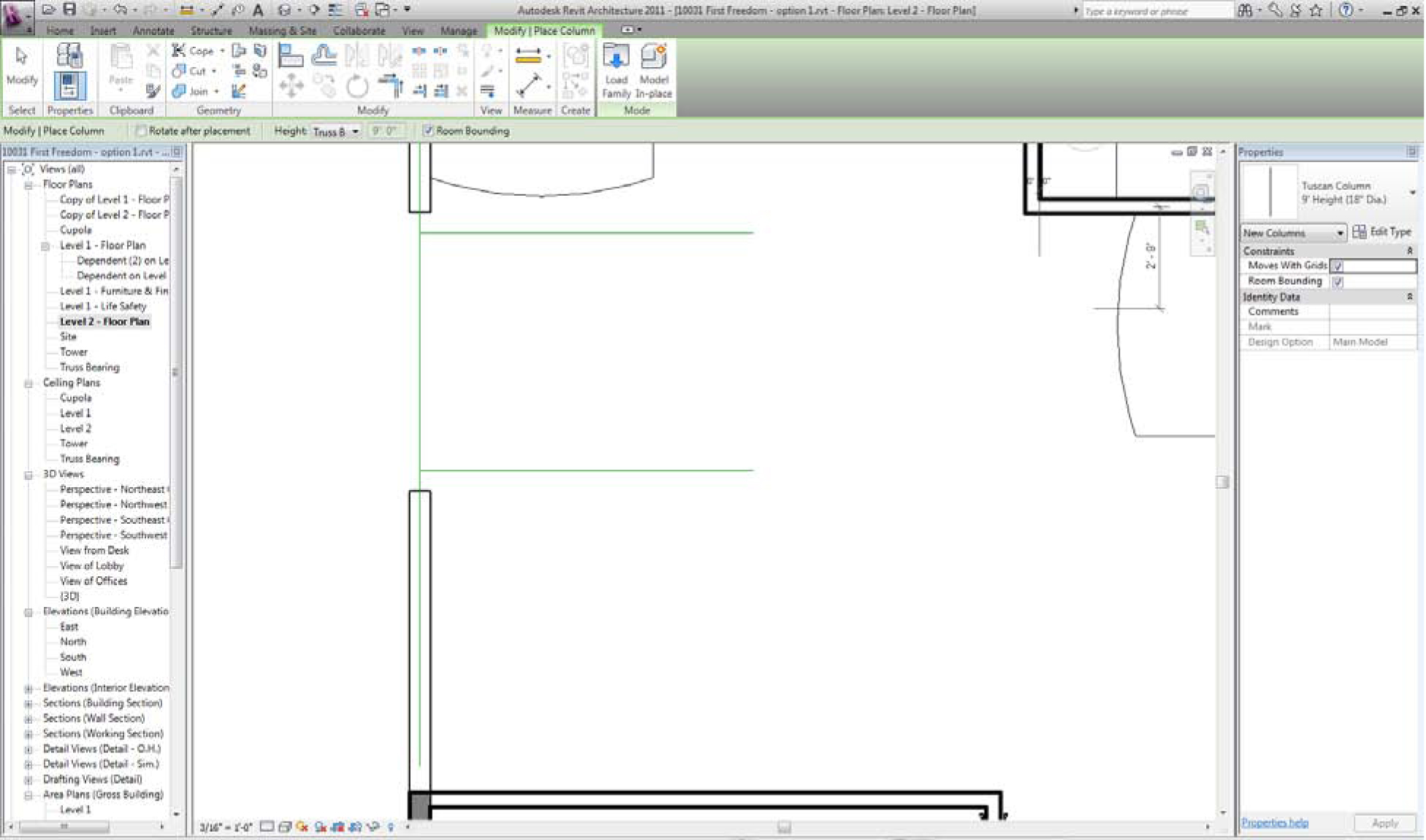

Give us a screen capture before you actually place the column.
ALT-PRTSC or Snip tool in Windows 7
Like attached.

Changing the offset doesn't do anything...it's as though it's constained.
And as far as I know, it's not a structural column. Is there any way I can check that? and I've attached a print screen image.

If changing the offset doesn't do anything, that means you do have some constraints set.Although I cannot tell too much from the printscreen, I do see that you have the column at a set height (9') rather than having it be from level to level. Also, it seems as though the column is constrained to Truss B/8 which you can change from the modify - place column toolbar.
This said, I do not see where your column actually is in the printscreen; i see walls but no columns.

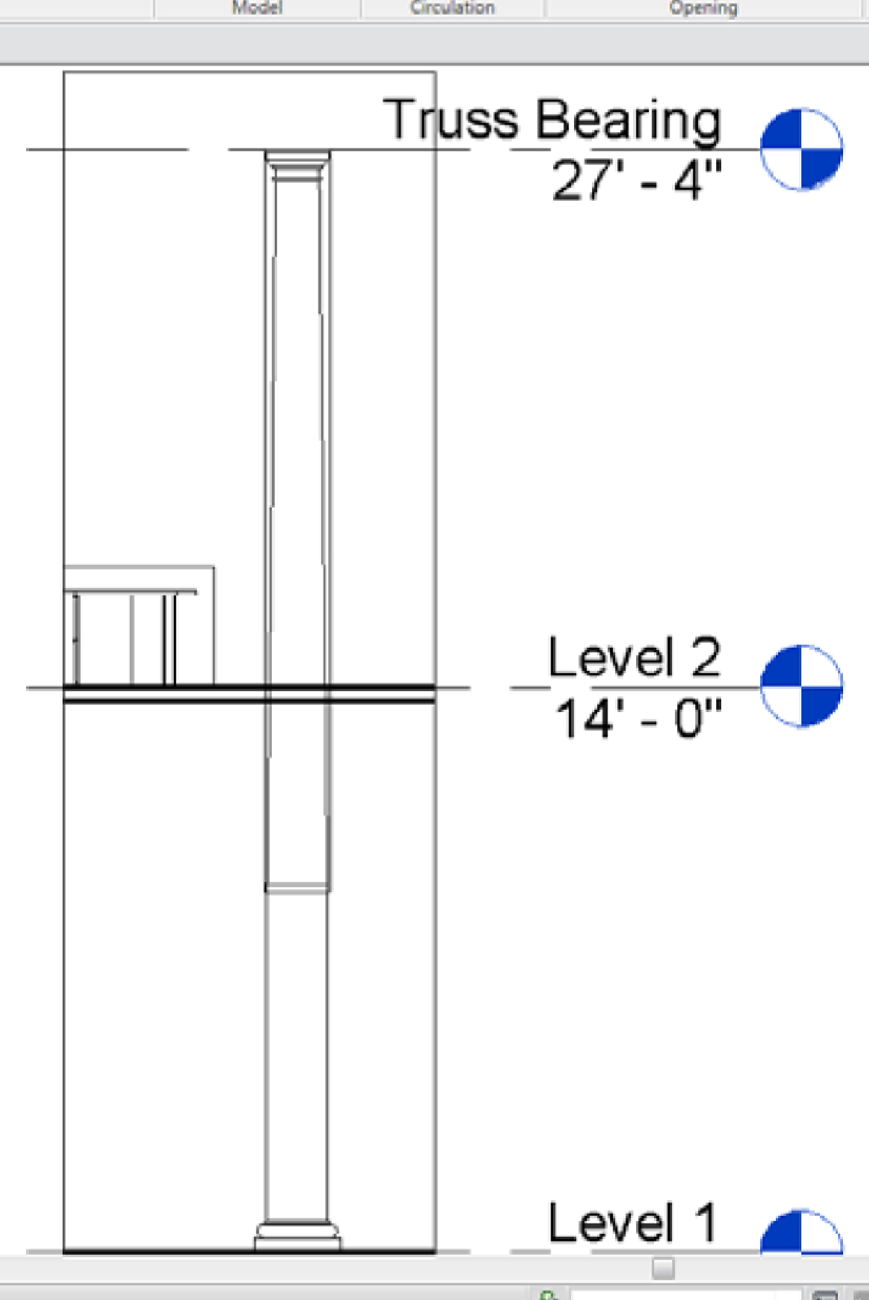

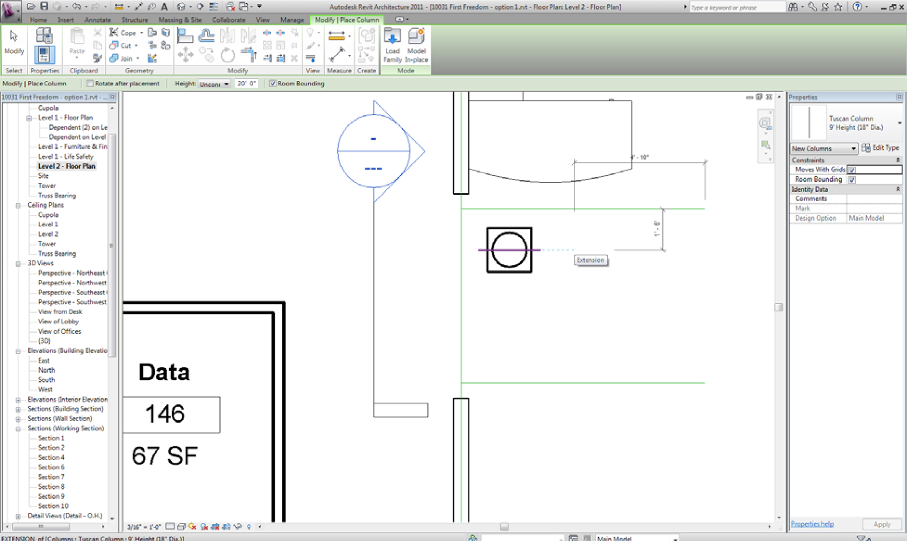

I've attached another print screen with a column placed. Additionally, I attached a section of that placed column. You can see how it's on the first floor, but extended up to the Truss Bearing Level. It doesn't matter if I have it set to Level 1, 2, 3, etc... it always is placed on the first floor. But the height depends on the level/height I have set. Is there any way I can "edit family" and remove any constraints that may be on the column?
