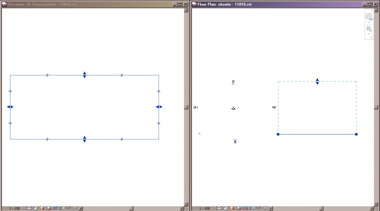

hello,
 i am missing floor levels. in elevation i can see 4 elevation heights when i click the east view but i have no 3rd or 4th floor. i have tried selecting the elevation and clicking 'find referring views' but nothing is their either. what happened to my floors?
thanks

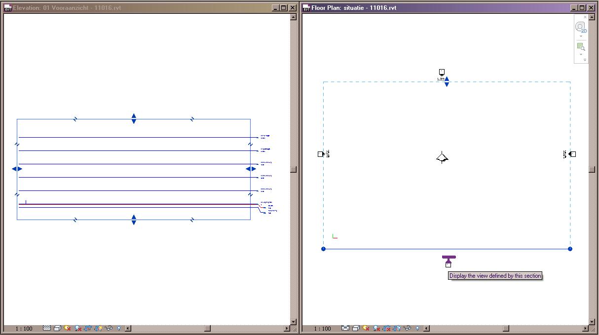

This happens and it's a bit tricky to figure out.
I try to visulize it in the images below.
Image 1 is what you go for.
Image 2 is your problem.
Does this occur on all elevations or just 1?
