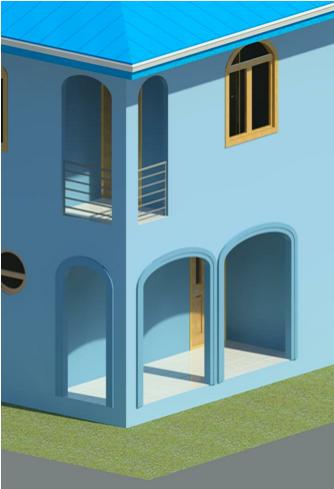

I edited the profile of my wall and created an eliptical acrhed porch entrance. I created a sweep profile but cannot get the sweep to run along the arched opening. Its like a moulding runing along the edge as an architectural feature to match those around the windows and doors. I have seen arched openings with cornice in gallery photos. Iwould really appreciate it if someone would make this easy for me to understand. Thanks.

I take that you mean to create a in-place family (molding) if you edit profile the wall.
if this is the case, you should be able to pick 3D edges (use sweep) when you are in the in-place family mode. then draw the molding profile (or use a profile family) and it should be it.
other alternative is to create a geneic family (loaded family) and insert it.
personally, i would do the latter since it is easier to control the behavior

I tried the first method and got the desired effect. Don't understand how to achieve the same result using the alternative method, but will try. I you can give a lil more details. Thanks alot. You've eased my stress.

sas27,
See attached
this is something I would  have done if you have many arch opening with molding to model.
By doing this, you eilimate the process of editting the wall profile, but to use this family to do both.
you can customize the molding style by creating your own profile family and load into the opening family. all other elements as your desire.
HTH
Philip
