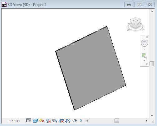

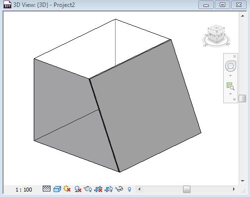

create a mass of any angle you want and apply a "wall by face" to get the wall effect you want Smile
 i've attached a sample model with mass ON and mass OFF to prove the point.
hope this helps Smile
