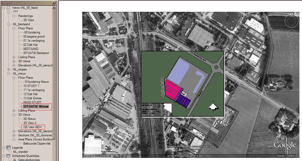

I'm using GE 6 aswell, works fine here.
When importing (aquireing) the the GE plan check the project browser, revit creates a new 3D view named GE View.
You should also see the GE image in the site plan view (Only in the active site plan no floorplan)
