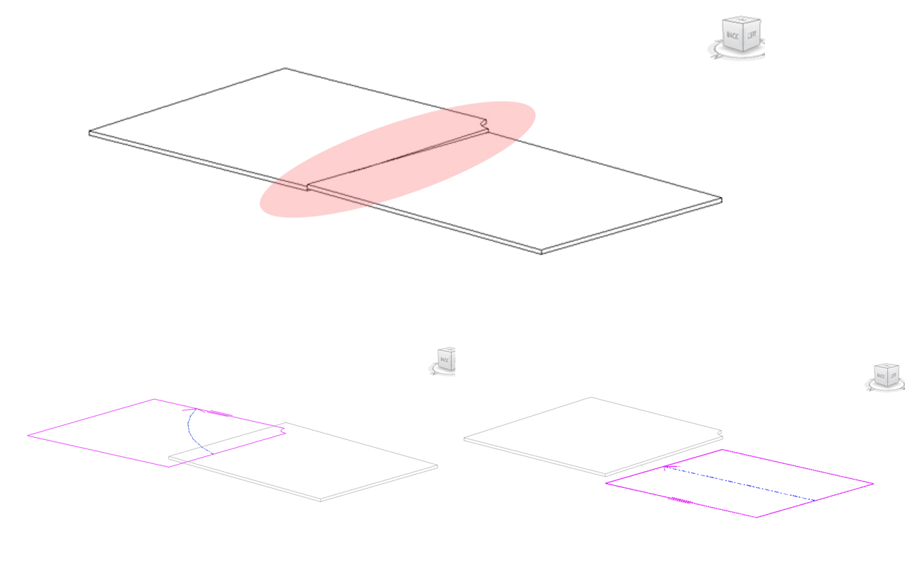

Hi, i am trying to create parking garage in revit. But i could not find the way to create nice sloping floor.In Revit 2011 i used sloping arrows in floors. However in corner rotation floor does not match the regular sloping floor. Maybe this is super elevation i not sure. Now i do not know how to solve this problem it effects all facades-sections in a wrong way. Thanks a lot.

It is ok.Problem was solved by using modify subelements. Thanks
