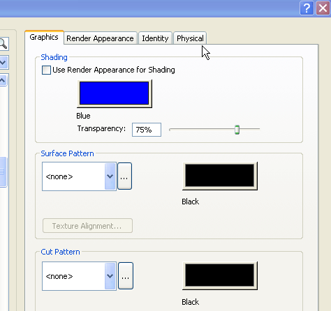

in Revit 2009, how do I modify the glass opacity? The glass is too clear, and I want to render it more sloid, like blinds are behind the glass, so I can see more of the glass color, like blue / green, or blue, but the glass is too clear, and I am not seeing the color in my renderings
 thanks
Tue, Feb 15, 2011 at 3:47:57 PM | Glass Opacity
Opacity is in the material settings.   You might think about having mutiple glass types in your project and assign accordingly

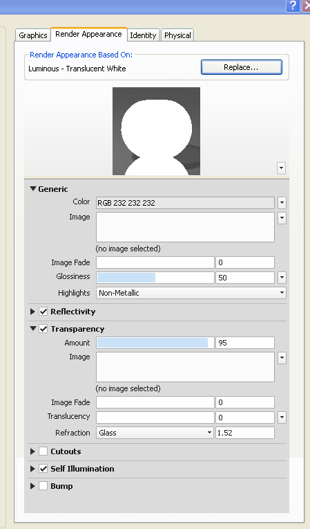

I hav eread a bunch of threads regarding this issue, but whenI go to the material dialoge box for my glass, and go to the rendered apperance tab, the only opptions I have avalable to me ar ethe following:
Settings/Materials/Glass (Material Class)/Glass (Actual Material Name)
Rendered Apperance:
Solid Glass Properties:
1. Color (transmittance)
2. Reflectance
3. Index of Refraction
4. Roughness
5. Bump Pattern
 Thats all I have access to, I still do not knwo where to find Opacity?
Pls I need help..hahahaha
Wed, Feb 16, 2011 at 7:56:07 AM | Glass Opacity
For shaded views see the first image - for rendered glass, look at the second image.  NOTE:  These settings are not available on all default glass materials>

wwhUB... THANKS.. that is exasctly what I needed.... wow.. i have been struggling for yrs to find this out.. thanks

It seems I have answered my own question as it seems there is an important toggle under material editor.
Graphics allows transparency
Appearance allows  reflectance
opacity control in shaded regions
