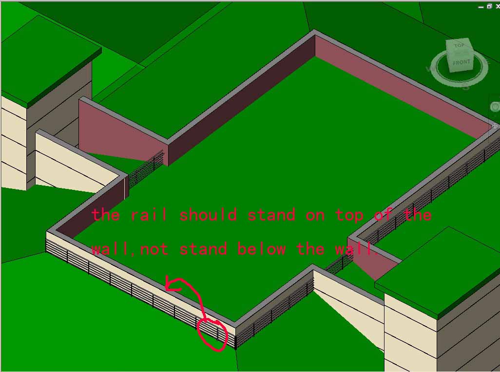

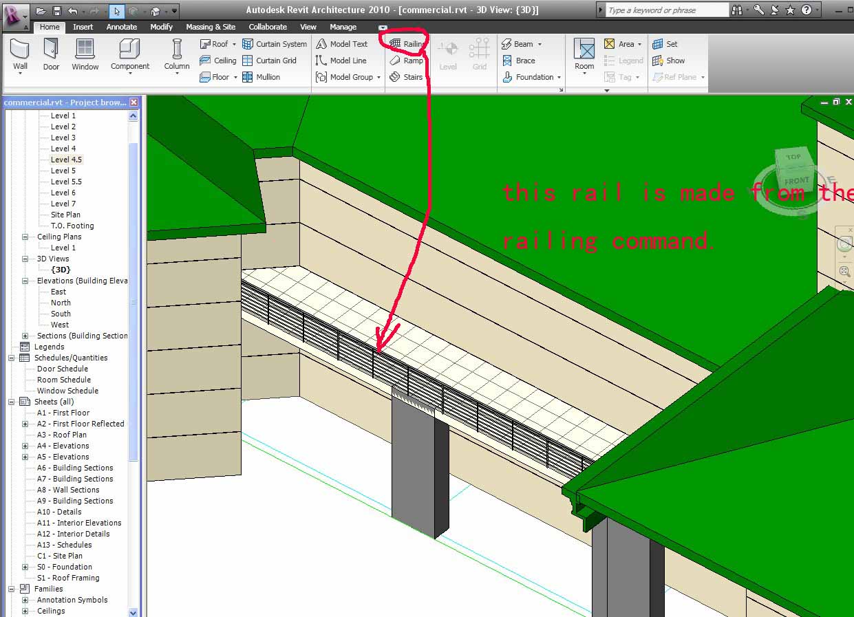

I want to add railing to my project, the style I want to made is shown in the sketchup picture28 , and I use the railing command, railing is shown in the picture30, how can I make a special rail? Also when placed the railing on my wall on top of building, railing is just below the wall, not stand on the top of the wall,see my pictue29. how can I adjust it ?

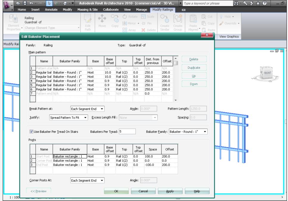

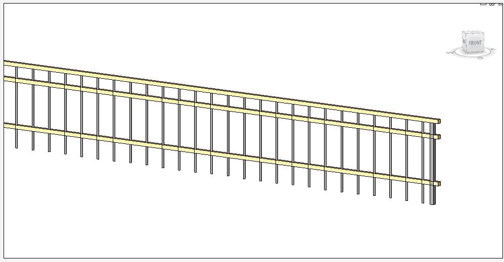

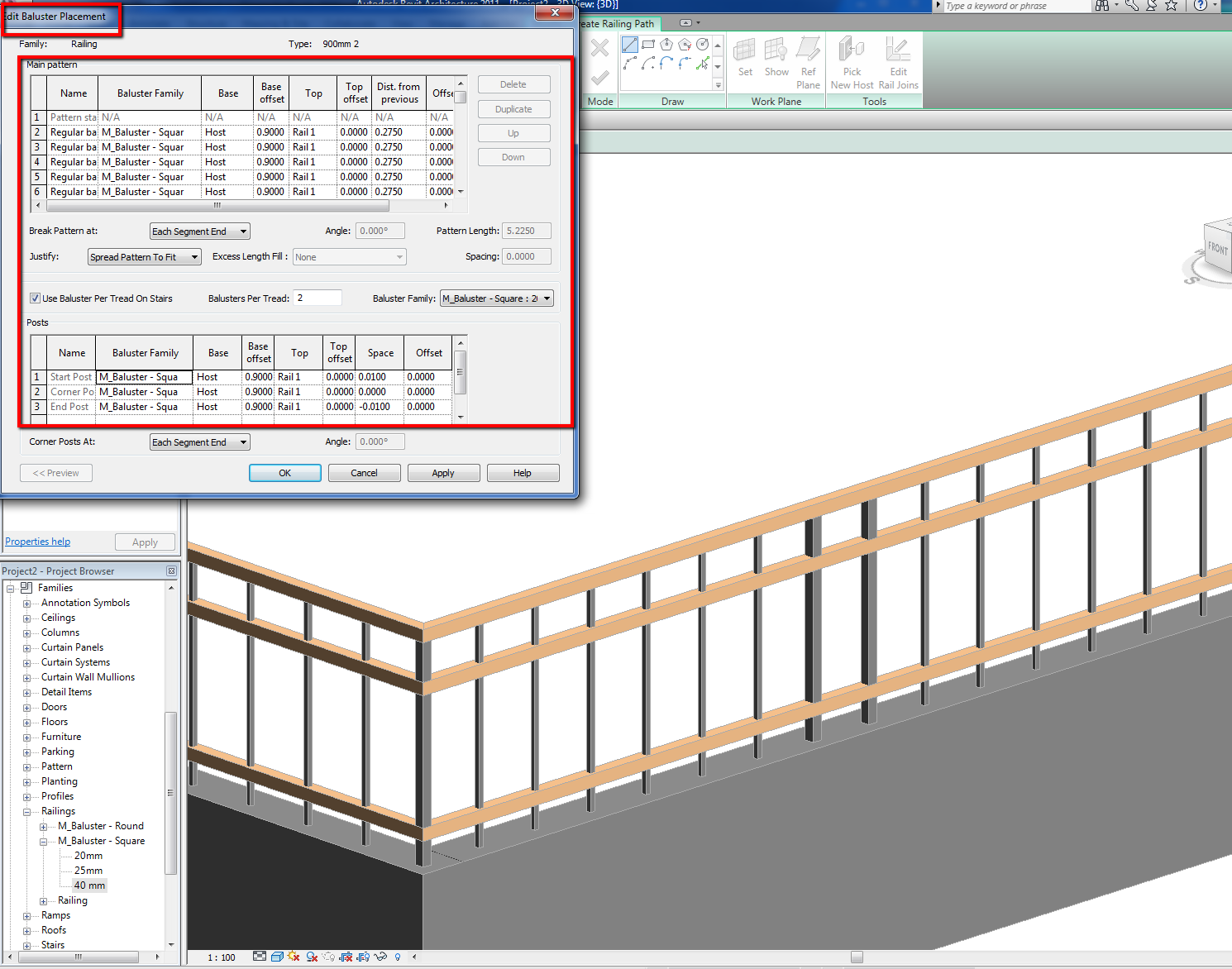

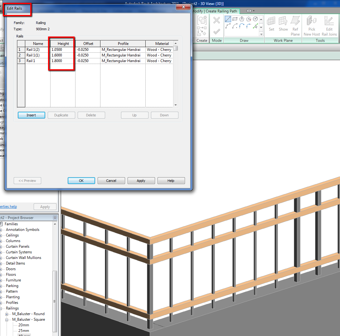

Sorry, I have tried what you told me, almost every thing is ok, but I still can't make the baluster like what you have shown me, look at the stronger baluster at the end of my model, see picture1, how can I add the stronger baluster in the middle of my model in a set distance pattern just as what you have shown to me see picture3. I have studied the parameter from your picture, and I also made on my baluster parameter, I don't kown where is the problem. seen my picture2. Thank you.

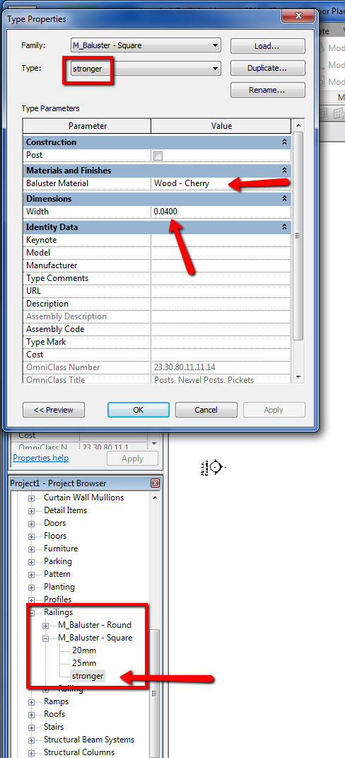

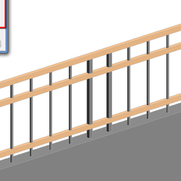

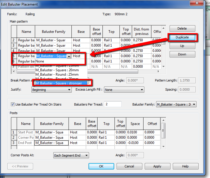

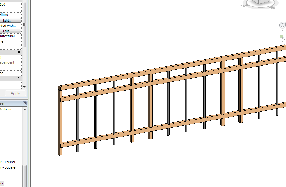

You need to "Duplicate" a baluster in project browser (to create a new one - Stronger) like you can see in my first image, then you can duplicate more balusters and change the baluster/post like you can see in my second image, then is just a matter of playing/adjusting the distance between them.
Also, take a look at this: http://images.dcheetahimages.com/au.autodesk.com/ama/images/media/AB114-1.pdf
 http://au.autodesk.com/?nd=class&session_id=5380

ok, thank you, I have done it successfully. much appreciated!
