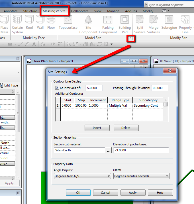

So, I guess the default setting in Revit toposurface builder is that the contours are displaced in intervals of 1' - 0", and I need the detail level to be increased in order to see contours at every 0' - 6" increment... does anyone know how to do this without physically drawing a whole new series of lines? Can I just increase the detail level to show contours at 0' - 6" increments?

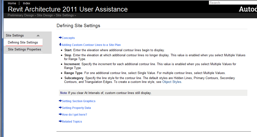

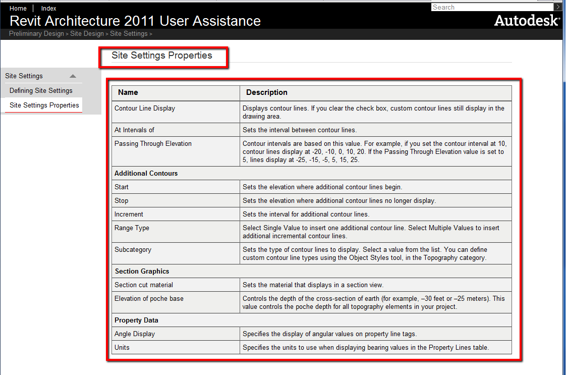

Look your HELP menu

that definitely helps, but where do I find those options?? Do I do it while in the 'edit site' mode? where do I go to adjust these settings?? I can't find it anywhere, I tried looking under site properties, and there are no such options.

Nevermind, I found it Smile thank you so much!
