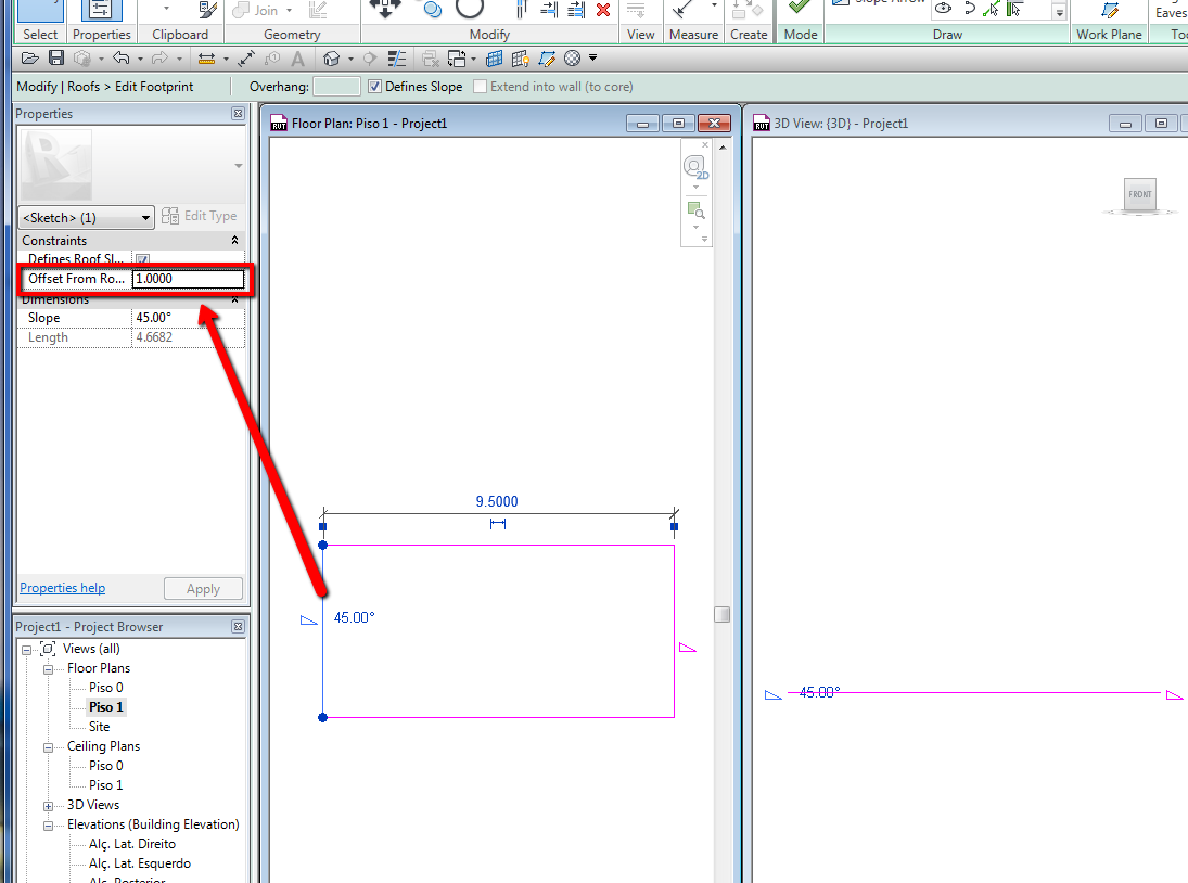

How do you create a gable roof where one side doesn't go all the way down to the plate?
Fri, Feb 11, 2011 at 1:37:01 PM | Offset Gable
Joined: Tue, May 22, 2007
5921 Posts
4 Stars: 205 Votes

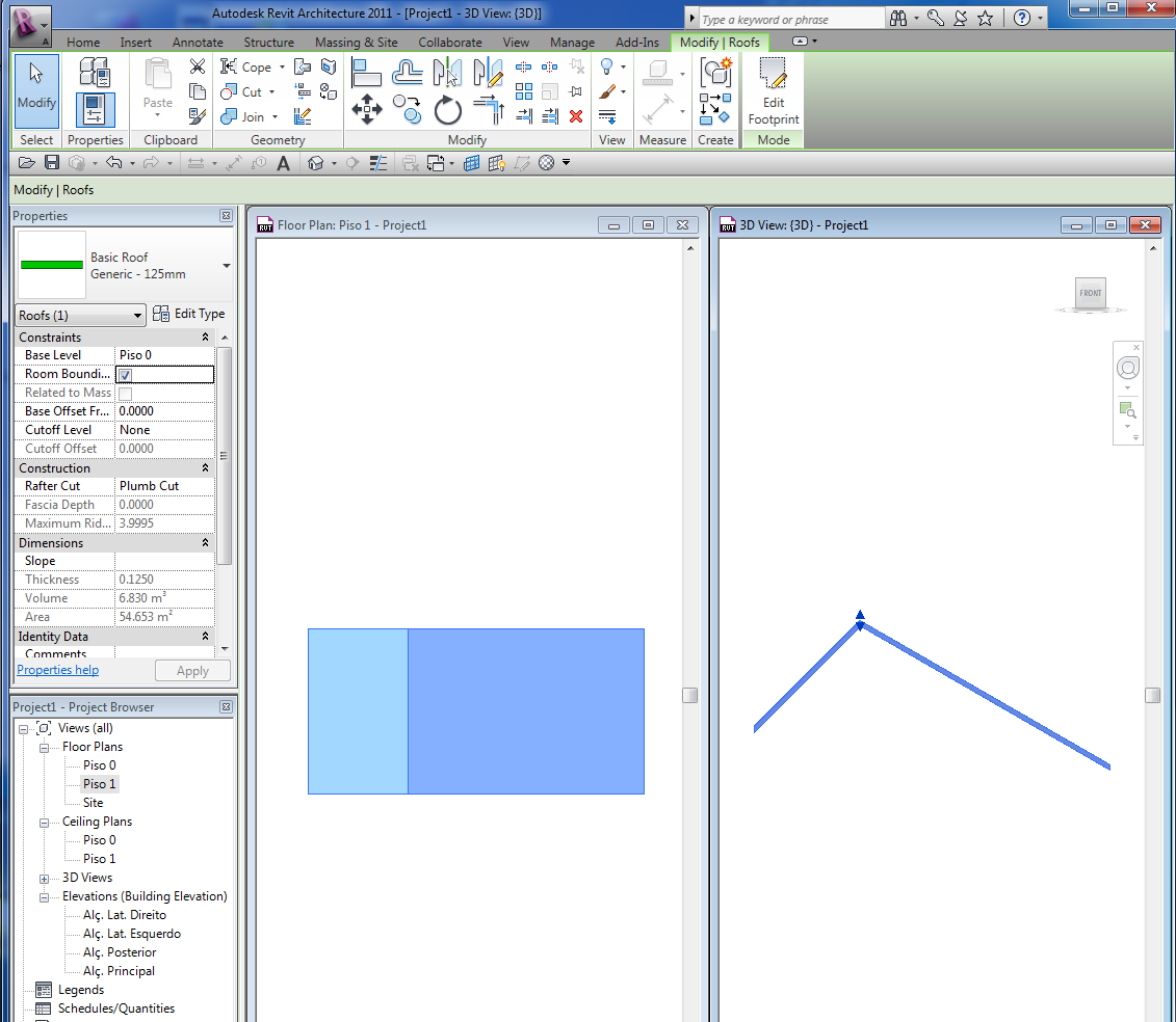

Something like my first image? just select the line then in properties change the "Offset from roof base" like you want
Fri, Feb 11, 2011 at 3:22:38 PM | Offset Gable
jazziz
Joined: Mon, Jan 21, 2008
3 Posts
Thanks, typhoon. I'll play around with it.
