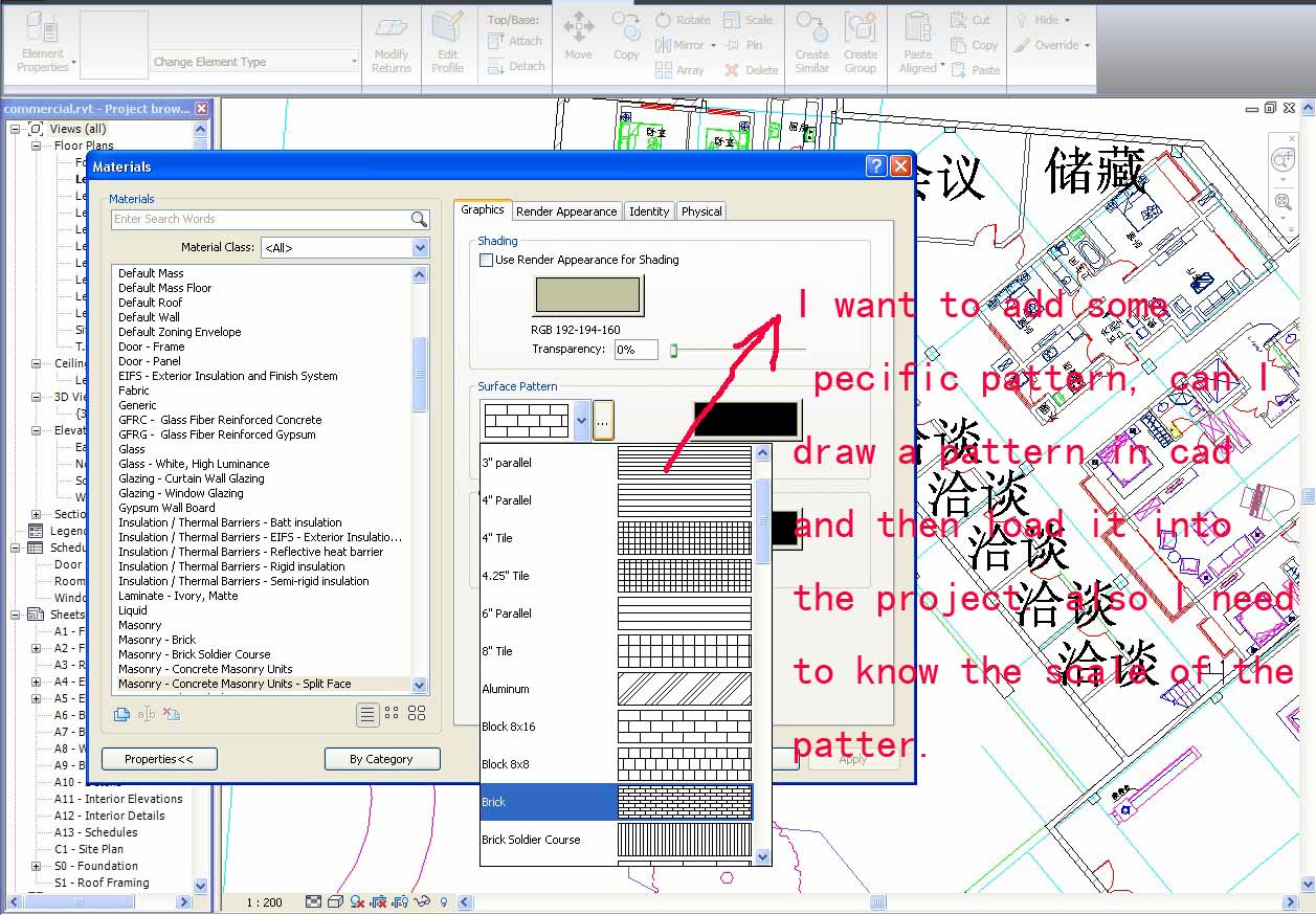

I want to add some pecific pattern, can I draw a pattern in CADand then load it into the project. also I need to know the scale of the patter. see my picture17

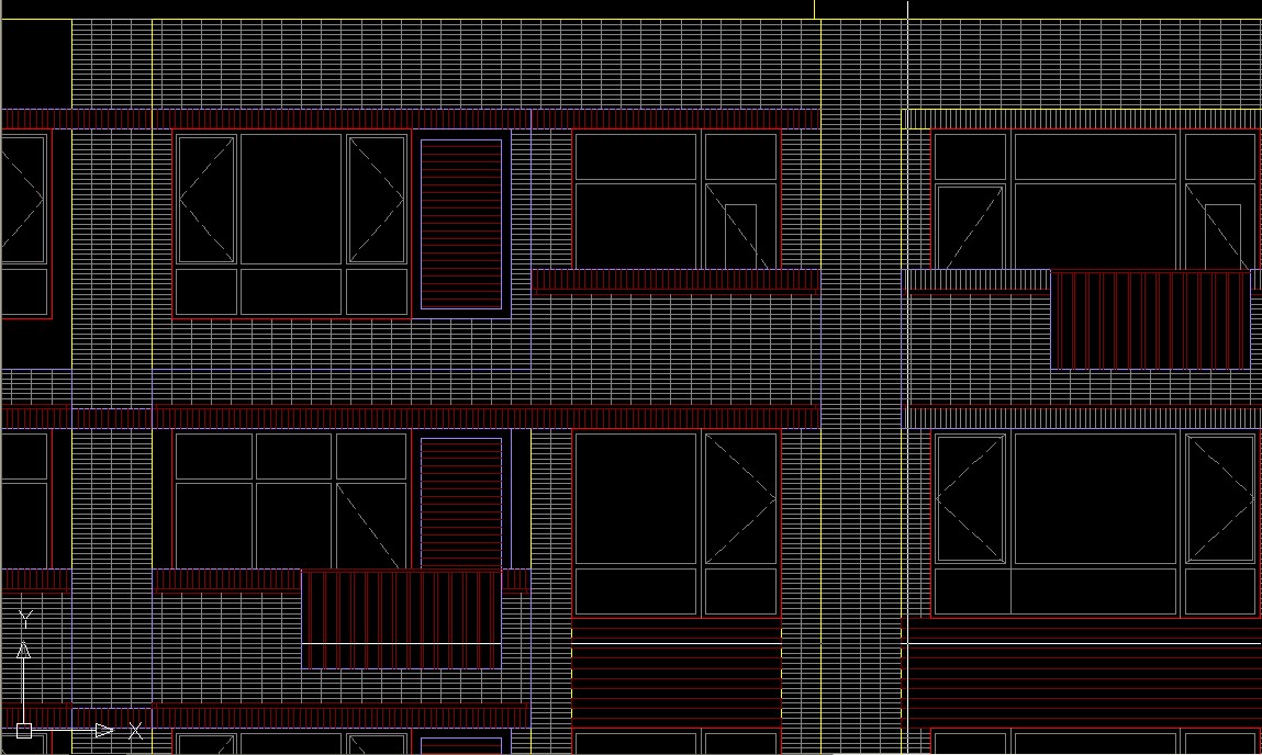

Because I need to draw elevation details and to show how the bricks or  stone materils arrange on the elevation. see the arrange of the briks in cad picture18

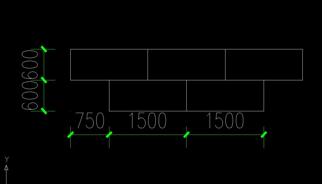

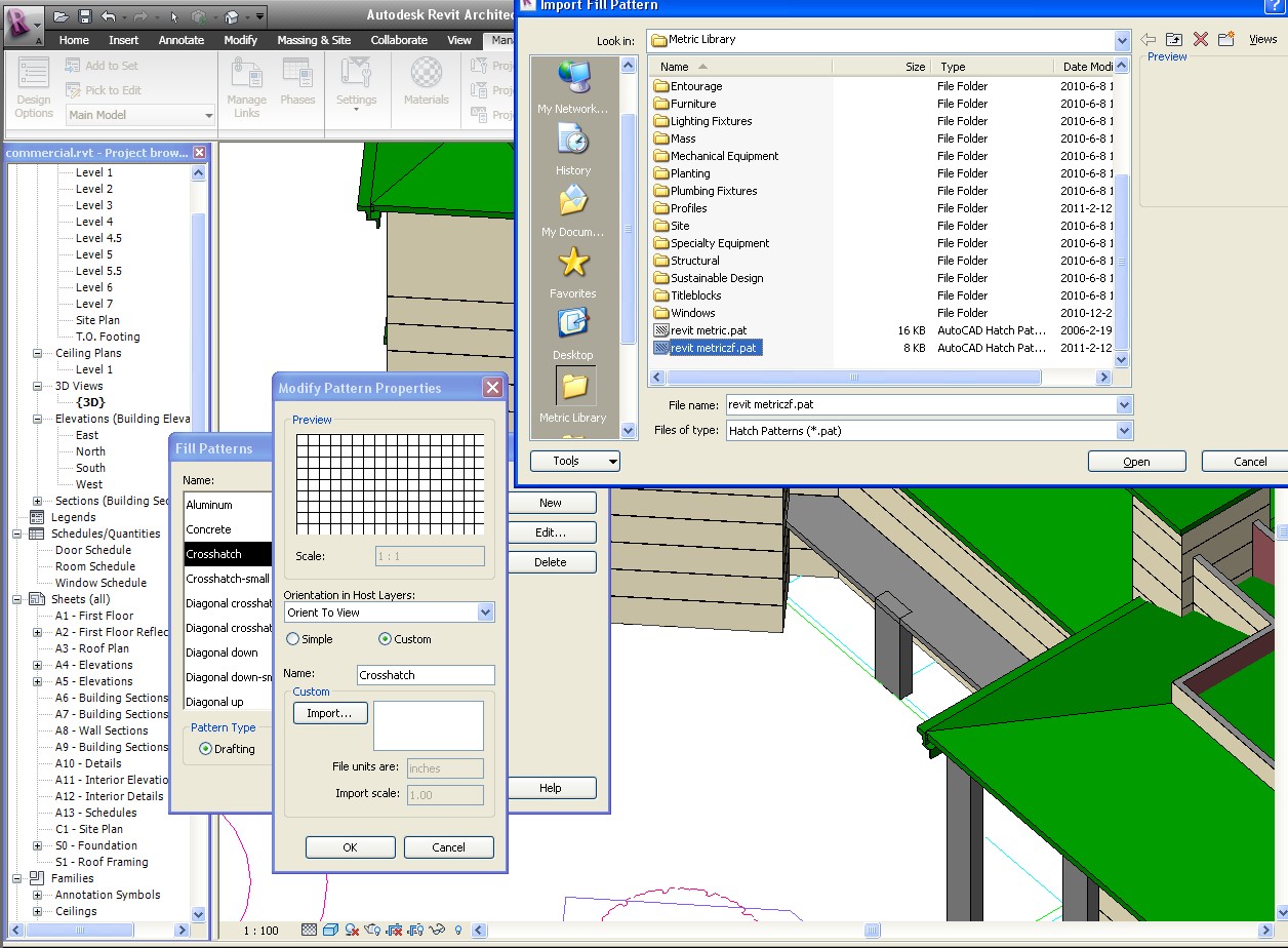

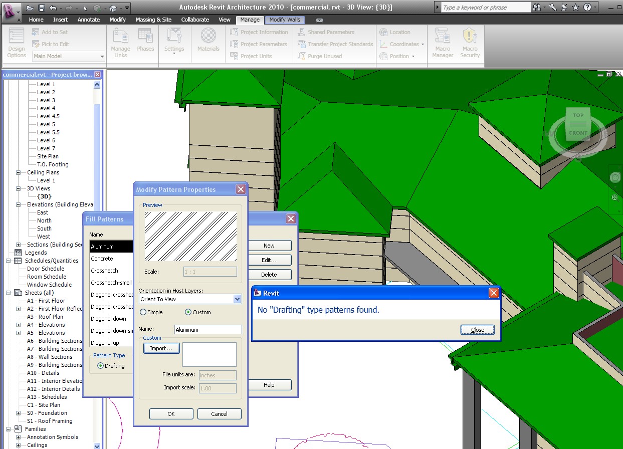

I have read the site and help files. and I know where to chagne the pattern. but when I load my own patterns, see picture27, the revit jump out the problem see picture24. I want to make a metric pattern see picture25, and I modeled on the the pat files which I found on net. it is my pat files . can you tell me how to edit the pattern files, thank you!
this is my patterns
;%VERSION=3.0
;%UNITS=MM
*VHUGOMG,Revitcity
;%TYPE=MODEL
0,             0,             0,             0,             60090,            0,             0,             750,             750,            600,             -600

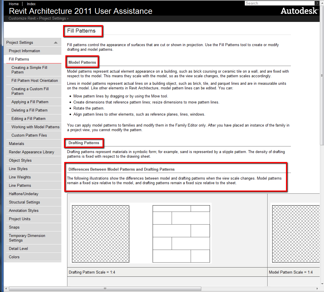

There are two kinds of "Pattern Types" - "Model" and "Drafting" do you know the difference between the two? look at my first image (directly from your HELP menu)
Look at your "Image 24" ---> "No Drafting type  patterns found", now look what you post:
"this is my patterns
;%VERSION=3.0
;%UNITS=MM
*VHUGOMG,Revitcity
;%TYPE=MODEL
0,             0,             0,             0,             60090,            0,             0,             750,             750,            600,             -600"
Can you see the difference??? Yes? No? well, this is the difference ";%TYPE=MODEL", you are trying to create a "DRAFTING" pattern with a "MODEL" patter, you need to change that "Model to Drafting".
How can you edit that pattern to change that? I told you before "...just search and read, you must learn how to use this site"....

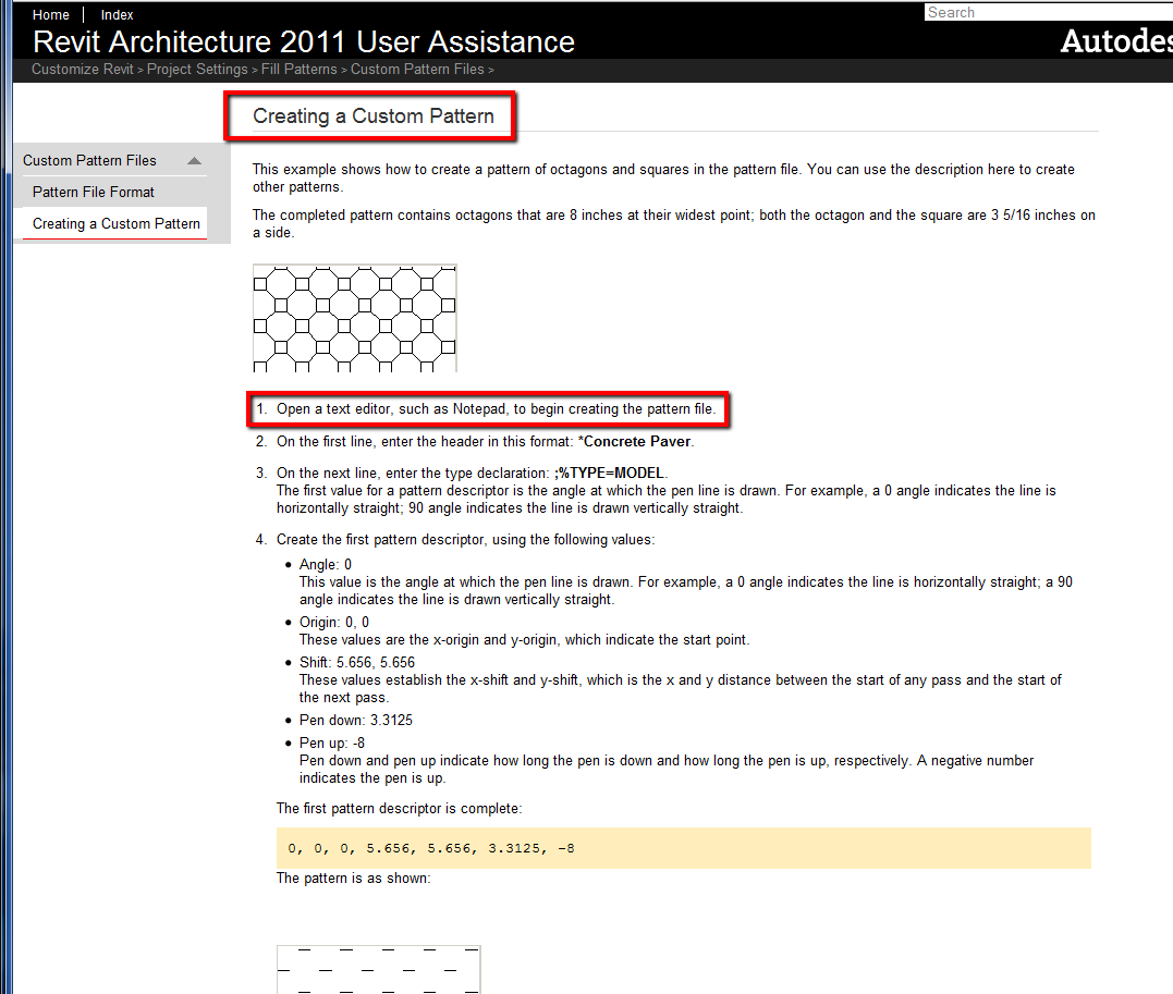

Just open that PAT file with a "notepad", change that and save, that's it, AGAIN, look at my second image.... Your HELP menu is your BEST TUTORIAL.

You need make one small change:
;%VERSION=3.0
;%UNITS=MM
*VHUGOMG,Revitcity
;%TYPE=MODEL
0,             0,             0,             0,             600
90,            0,             0,             600,             750,            600,             -600
