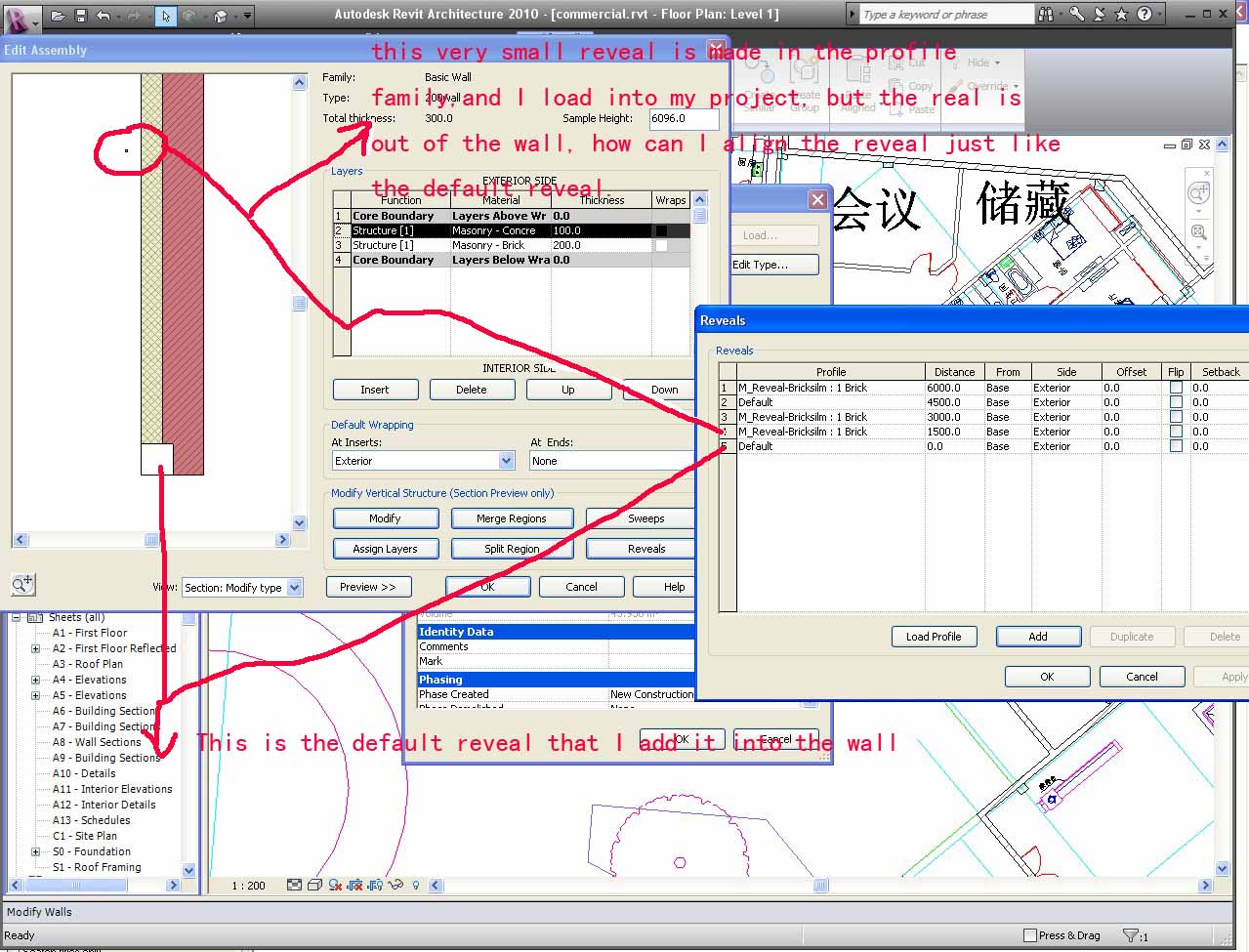

See to my picture16, I want to add reveal to my wall through edit wall type structure, when I add the default reveal, it is ok and align well to the wall, but I want to rather smaller reveal, so I make a reveal in profile family, and then I load it into my project. But the result is that the loaded reveal is out of my wall, how can I add the reveal align to my wall just like the defalut reveal placed in the wall?

Just look your image, do you see the "Offset" column??? play with that....

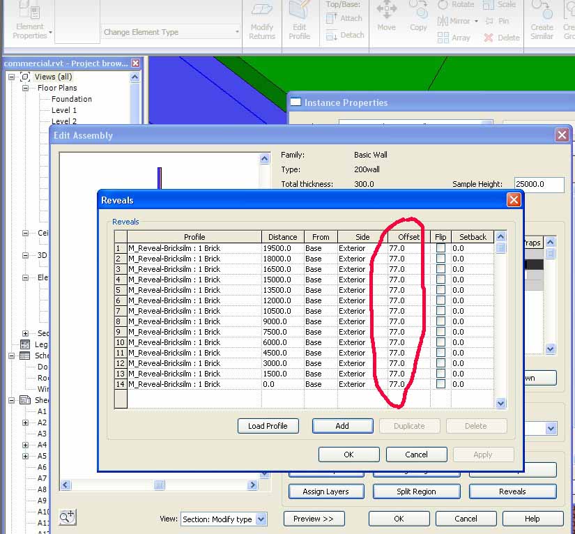

yes , I have resolve the problem yesterday, buy using the "offset " seen my picture 21.

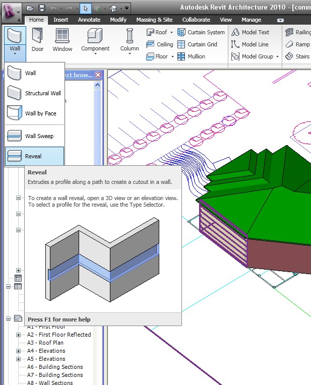

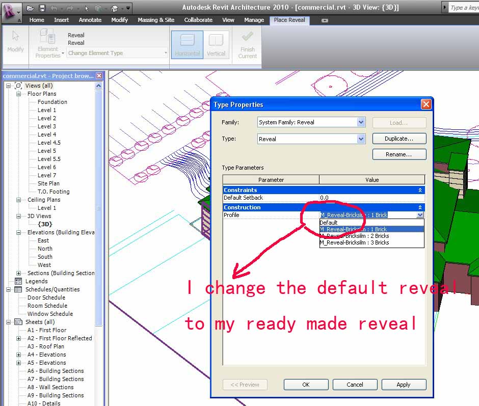

But when I use the wall tab reveal, seen my picture19, I also want to use my self made reveal, seen my picture20, but it has the same problem as edit wall type, the reveal is out of the wall. how can I fix the problem?

I don't have any problem with that and we can't see the issue with those images

I have know the problems , it is I offseted the reveal profile from the orginal point.
Thany you.
