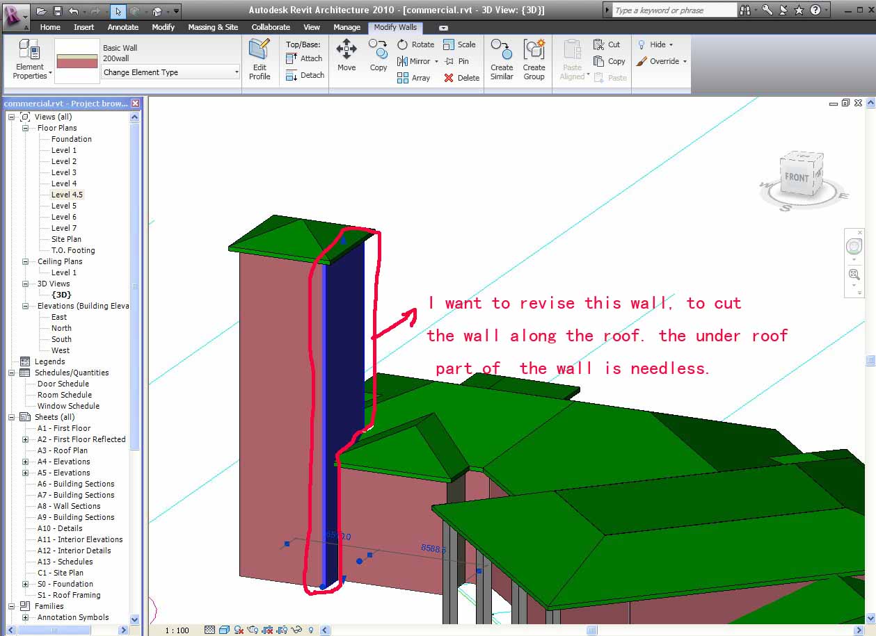

look, I made a tower of the building, and the wall of tower is higher than the roof , how to cut the wall along the roof? I have known the attatch command, but it only delete the upper wall of the roof, I want to delete the wall below the roof.

This question is a little unclear to me, you say: "how to cut the wall along the roof? I have known the attatch command, but it only delete the upper wall of the roof, I want to delete the wall below the roof." this not clear and by the way, when you select a wall you attach the TOP and the BASE of that wall, just look at your ribbon after you click on "attach wall" button.

i think you mean to stop the roof running into the wall, for this you could use an opening by face to get the roof to stop were you want it too...

"i think you mean to stop the roof running into the wall, for this you could use an opening by face to get the roof to stop were you want it too..." - Well, if this is what he want I think I use the "Vertical Opening", with this way the opening is perpendicular to a level and not a face.
Let see what he really want...

yes T, that way works just as well... which ever takes your fancy FW

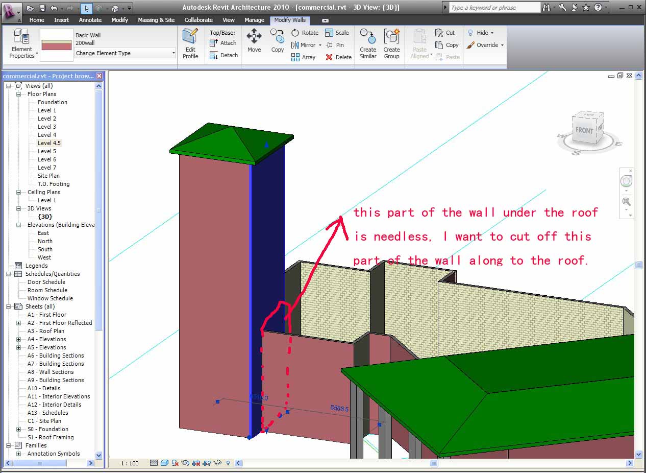

sorry, what I mean is that to see my picture12, the hightlight bule wall is what I want to revised. Actually if I hide the roof the wall would be look like the picture13. What I want is that I want to cut the wall under the roof.

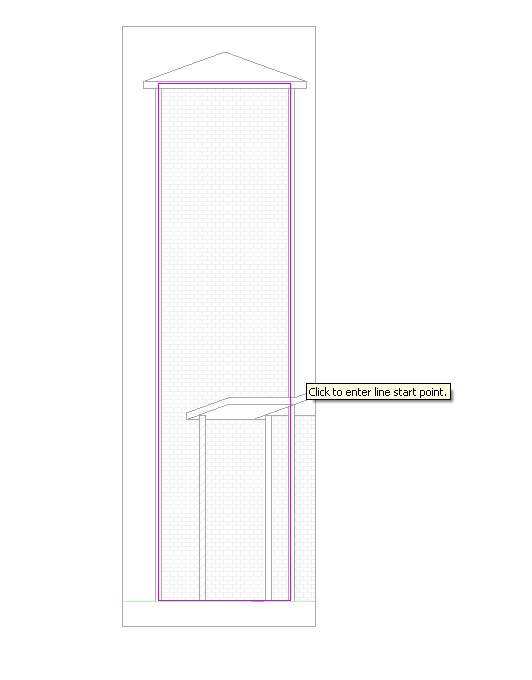

is that to edit profile of wall in elevation? see my picture15

ah, right, yes edit the wall profile in elevation to remove the bit you dont need
