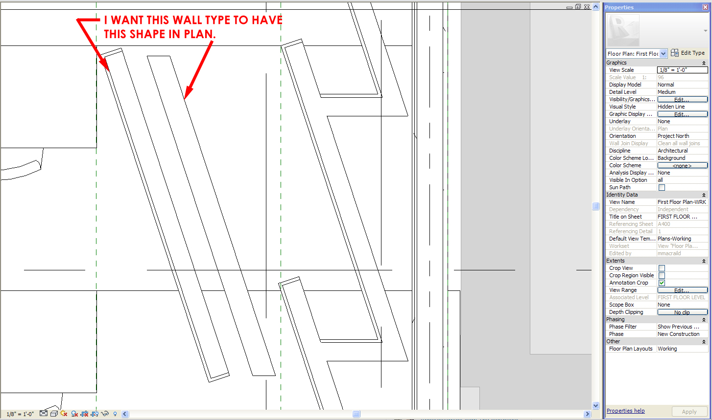

I have searched the last few hours, tried a few seperate workarounds and am coming up with nothing, so now I hope someone out there can help me.
I'm looking to create a wall at about a 30 degree angle, but want the ends of the walls to be flush to the horizontal, not perpendicular to the wall.  I have attached an image to give a better visual.  I can create an in-place family and change it to a wall, but it doesn't give me the ability to create the structure and materiality that a basic wall allows.
anyone have any suggestions?
Thanks in advance!
~Matt

If you dont want to create that in place you can cut that with voids then in plan view create a "filled region" with the material you want.
