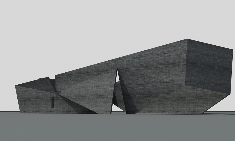

how to model this in revit

This should be easily done now by creating a conceptual mass and load it to the project.
Then you can create the wall by using "wall by face" via wall command.

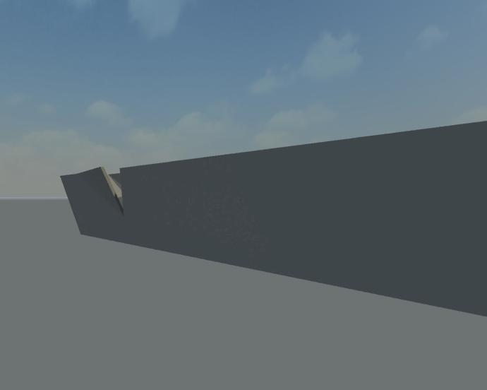

Tried that but it seems it works more with curved surfaces no trangulated ones

It is possible using conceptual mass and you can create the form using reference point
See attached
