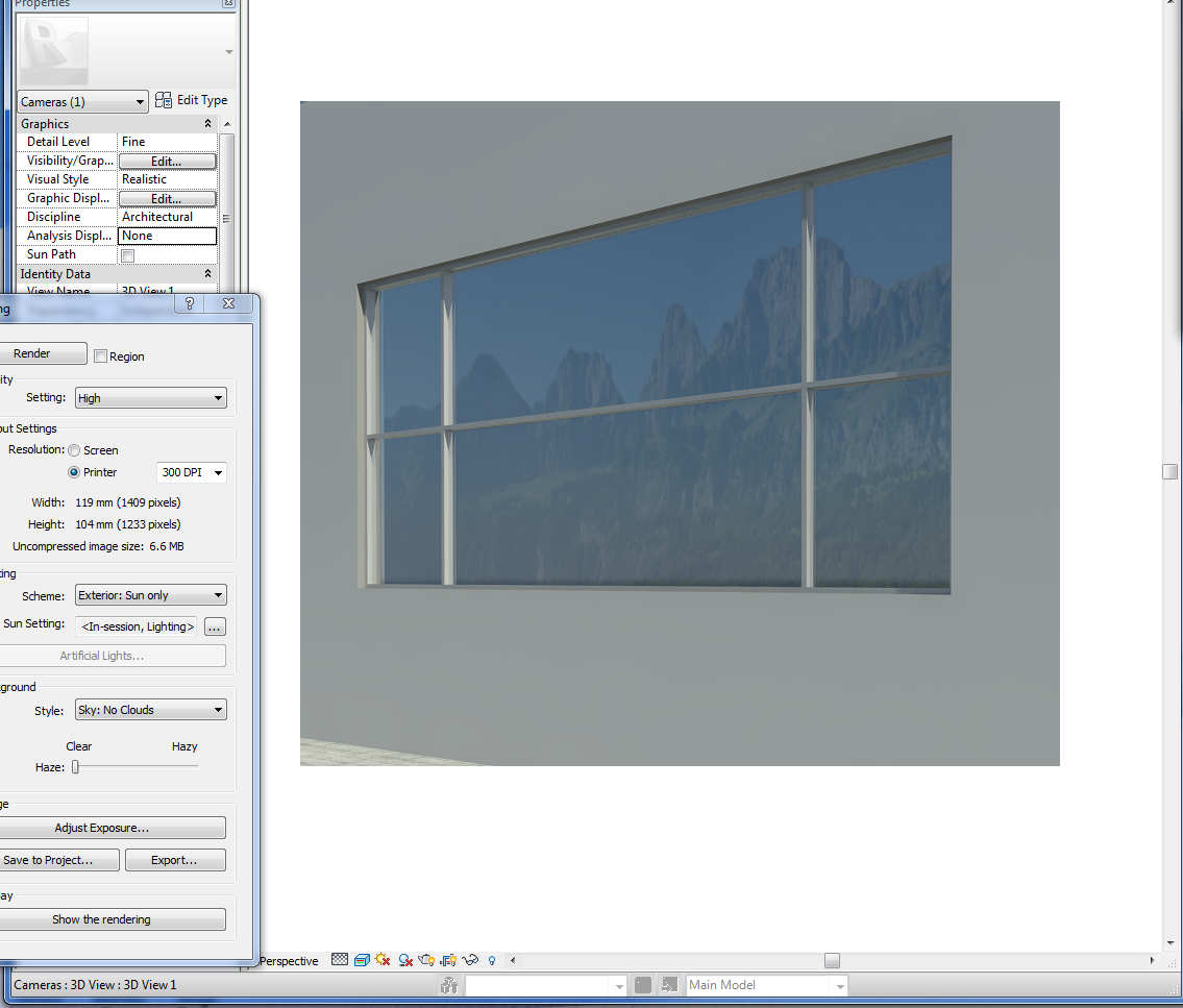

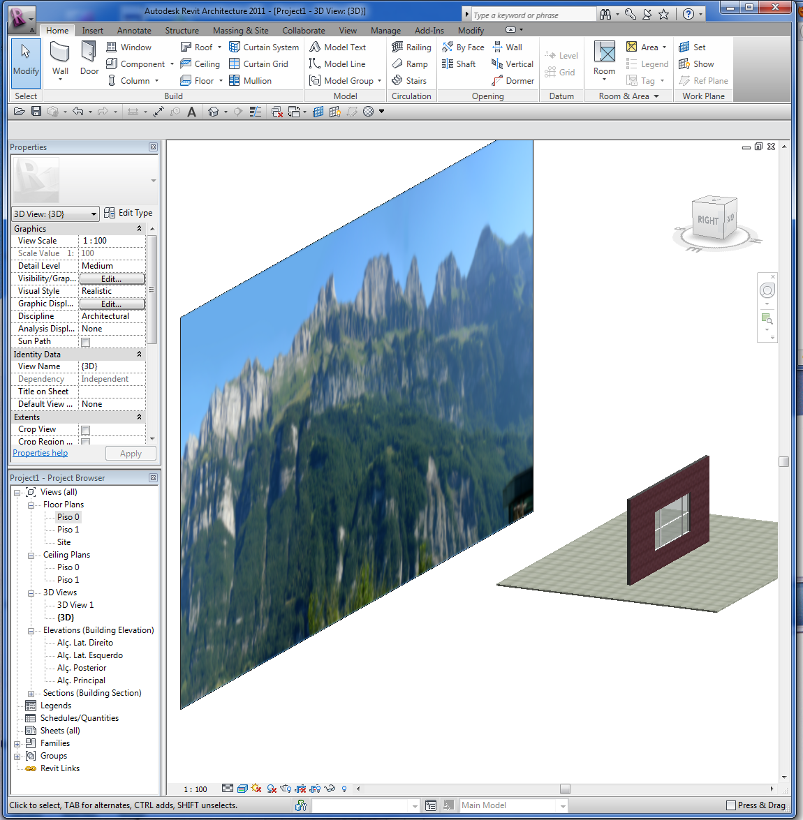

Something like this? place a "Decal" like you can see in my second image and turn on the "Reflectance" in your glass material.
HTH

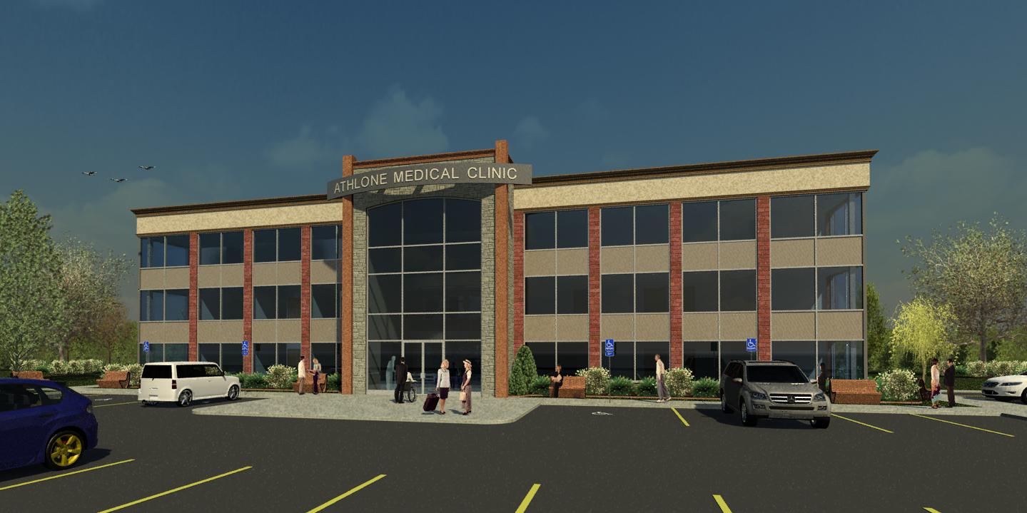

Tue, Jun 11, 2013 at 10:41:11 AM | Can Revit's Mental Ray use a HDRI style environment for exterior reflections?
westdy
Joined: Mon, Jan 21, 2013
9 Posts
I have tried this but the position of my camera is much further from the building, when i but the decal on the wall that is about 30ft high, the wall ends up casting a shadow because the sun is located somewhere behind me to brighten up the front of the building. Ive tried putting a line of trees behind the camera to break up the reflect horizon line on the first floor, but they dont seem to appear, an ideas? Id like to keep the camera angle, as i alredy have different angles like the one in the previously posted picture.

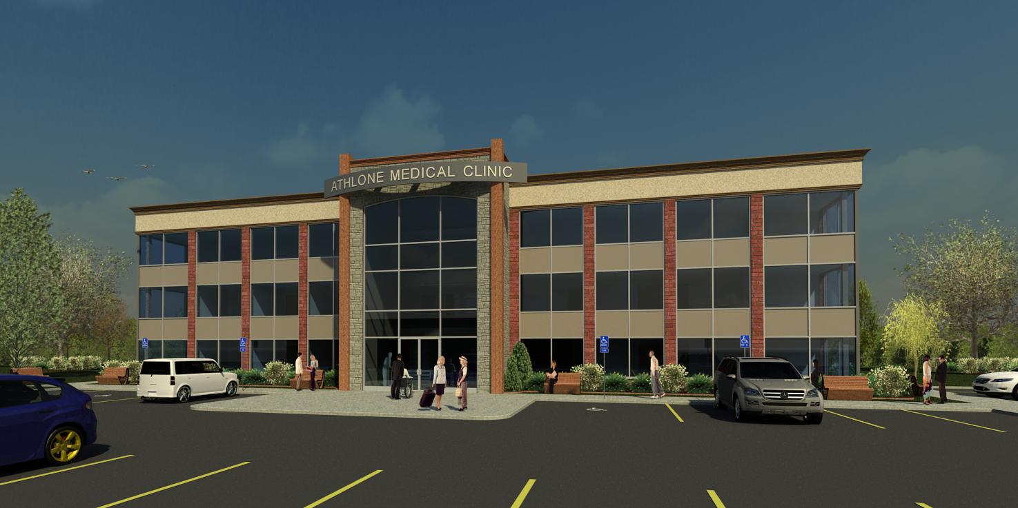

Wed, Jun 12, 2013 at 8:39:36 AM | Can Revit's Mental Ray use a HDRI style environment for exterior reflections?
westdy
9 Posts
Tried the decal wall but placed it back alot further, used a higher setting, and heres what happened...
Theres a clear black square in the reflection which means I need to make this wall huge, but then it affects my sunlight. So i figured a simple solution was to use trees to break up that white horizon line, but they dont appear. Ive placeed them at ground level and +10' above and nothing. Why dont they show up?
