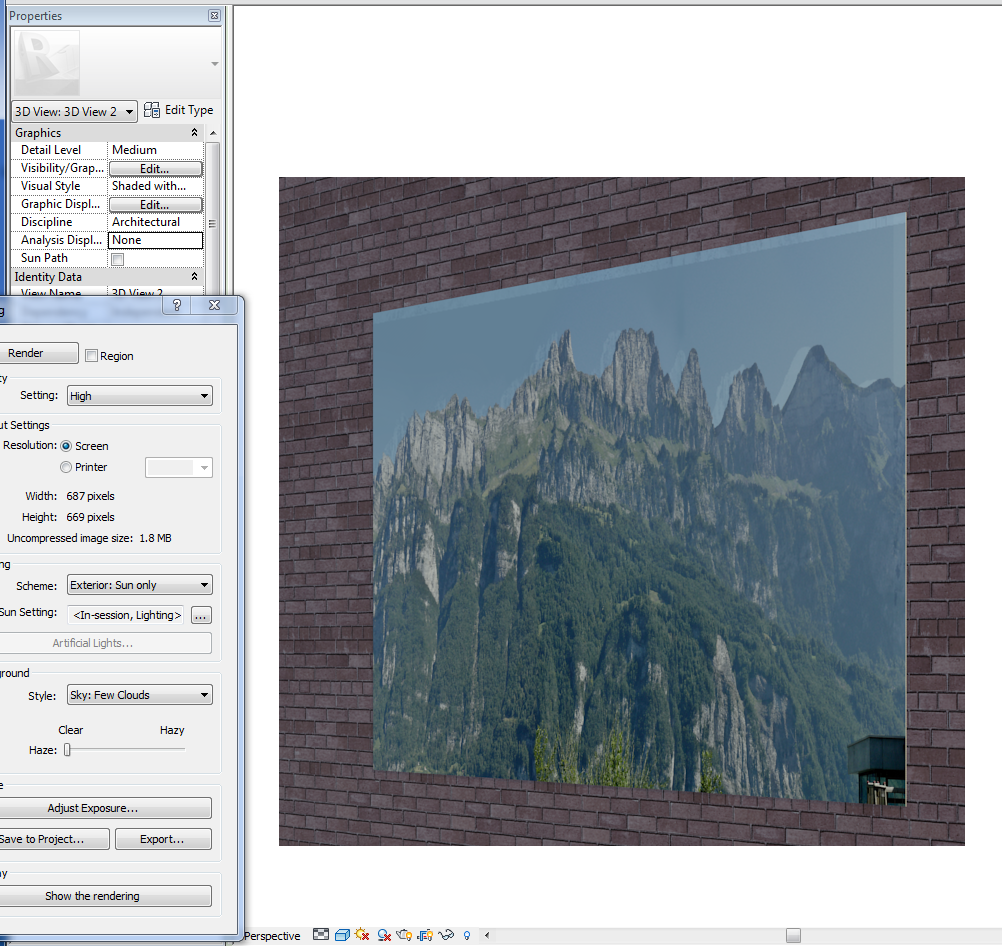

Yo cohorts! New kid on the block here. Can someone point me to instructions on decal property adjustments. Every time I insert a decal it comes in partially transparient (i.e. I can see the materials behind them before & after rendering). It looks really bad & throws toe colors off.  And I can't seem to figure out how to make them 100% non-transparent, even though I have them set to 0% transparency Using Revit 2011. Thanks for the help people!

You must create something thinner (like a thin wall) with no texture, only with color between that decal and the wall (in my case), then you apply the decal to that thin wall.
Hope this can help you.

Thanks Brother Typhoon, that was it, I had a feeling it was something simple. Your Karma is has just been downloaded & updated to the latest version; Karma 2.0. Thanks again...
