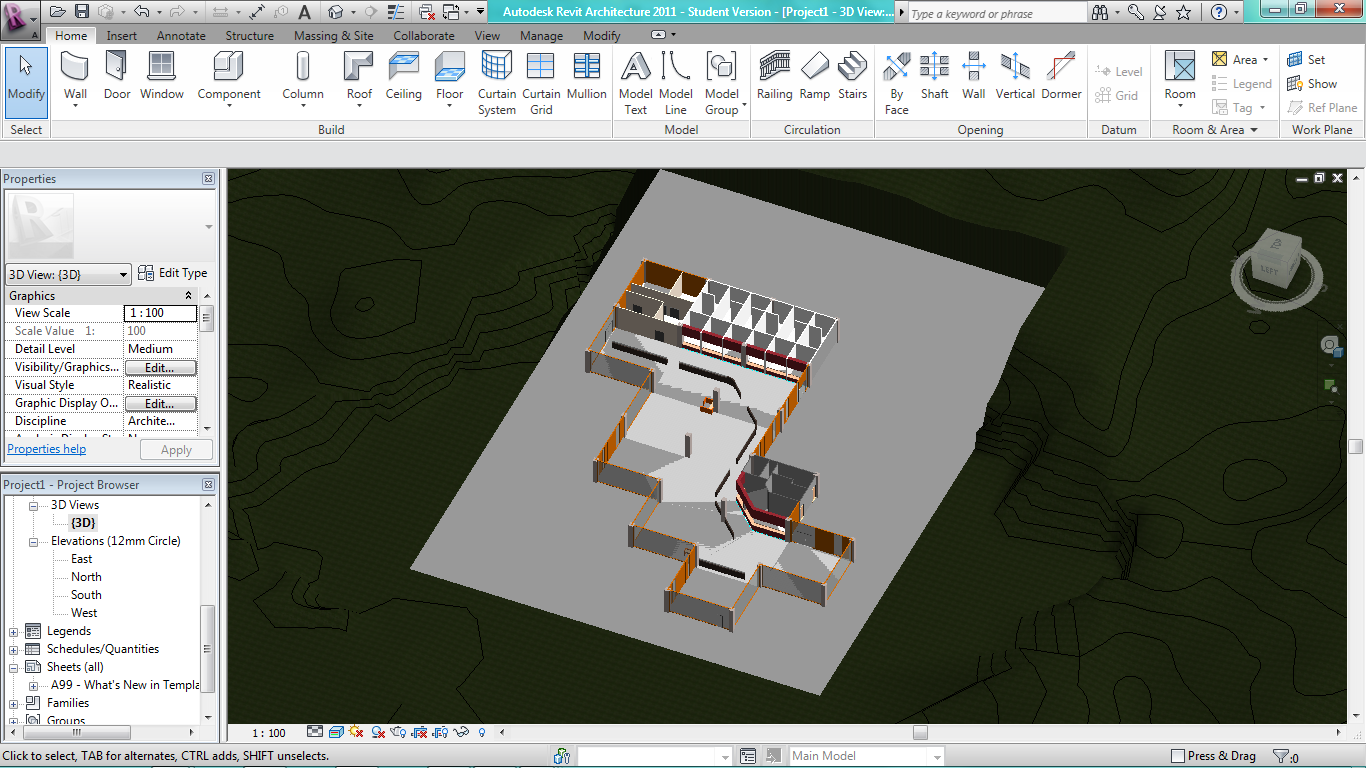

Hi everyone,
I apologise for making a double thread of similar content, it seems I cant reply to my previous thread. I was recommended to raise my building of the ground level, in the previous thread, how do I go about doing that?

goto manage project/location/position on the ribbon, read through the levels modifying area. or in elevation grab everything and move it up, or grab the ground and move it down.
