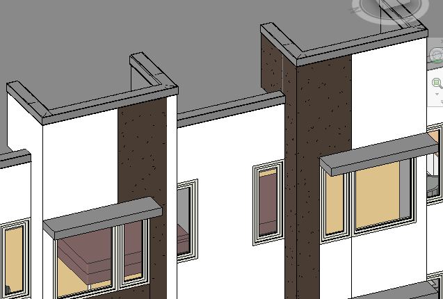

So I'm having an problem trying to "paint" these bays.  As you can see in the image below, these are modeled groups I've created and the only way I can change the color is to edit the group and paint them.  The issue is that when I finish and close out the group, only the group instance that I edited has the painted corner on the side, while the rest don't.  Is there a fix for this?

Not sure why you are painting a corner... wall joins should have taken care of that.
Sometimes it is better to split a wall vertically and have tow different walls - each with a different exterior finish.
