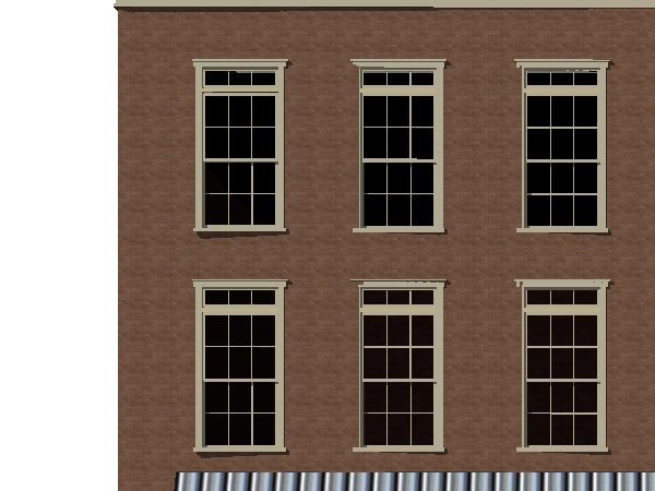

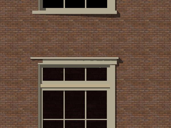

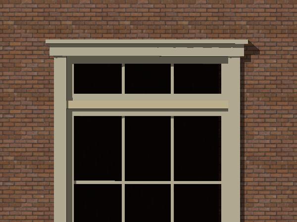

I have windows and doors that have the wall materials bleading through the trim when i use the realistic view style.  Is this a graphics card issue?? or is there something I can do to remedy this??  See pictures below of what the window should look like and what a few of the windows look like (it is doing it with doors as well).

is it just me or does it look like the windows aren't parralel with the wall face? is the window crooked and slightly recessed into the wall on the one side.

You are correct DeifyMe, something is terribly wrong with this family because it is at an angle with the wall.

That was my first thought as well, and upon further research this is not the case!  In the elevation view with realistic on the windows are fine, but in a 3d camera view, some of the windows and even some of the doors are doing this... oh as well as a cast stone window header that was put in.  This is the first time I have used the new realistic view setting and I  really like it for quick views, but I do not like this problem.

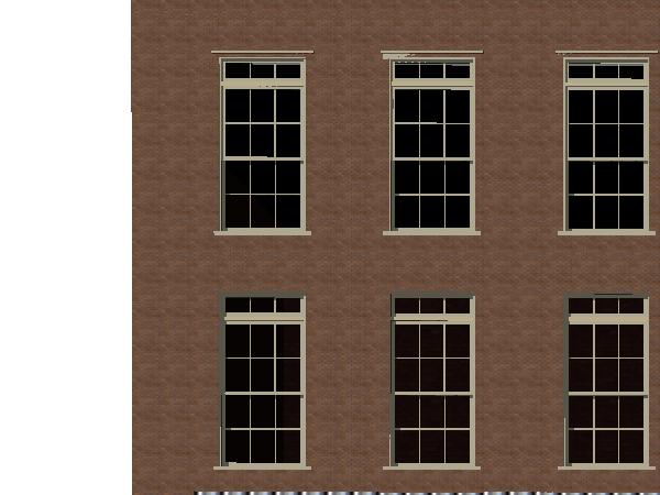

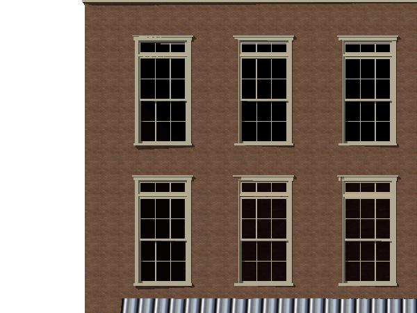

Here are the same 4 windows, one in regular 3d view, the other in 3d cameral view.

Just because it "looks" correct in 3D doesn't mean it is.  Post a plan cut through the window with an angle dimension from wall to trim ouside the wall.  I bet they are not parallel.

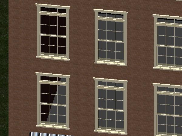

Window and all parts are parallel to the wall.  I really think it has something to do with the graphics.  Here are 2 shots of the same windows, one is a camera view, the other is the same camera view, duplicated and rotated a little!  I have a feeling there is no fix for this other than a diff computer.  Anyone else out there seen this???

wierd, this can only be a graphic card issue

It will not do an angular dim when it is parallel, I tried.  I did edit the window family and added 1" to all the trim and now it all looks correct and looks parallel.  Always a work-around! Smile
