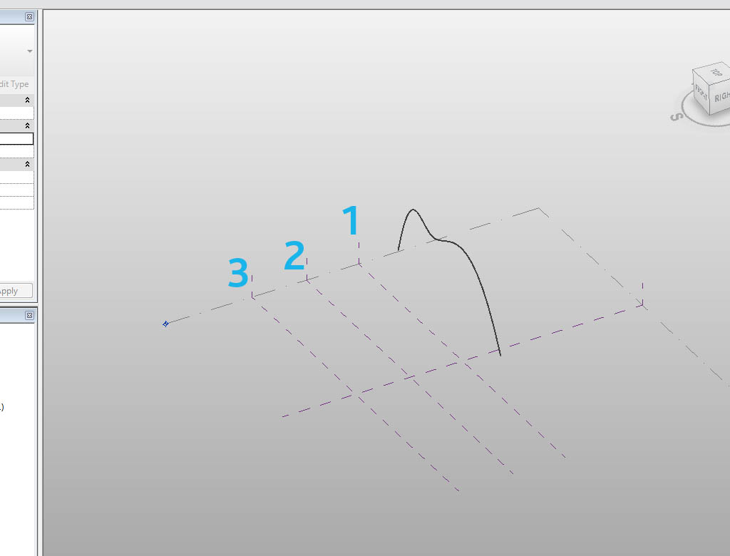

I feel stupid asking this question as I feel line I should know the answer.
How do you copy objects drawn on one ref place to another in the Conceptual Mass family editor?
I'm creating several profiles on reference places which I want to create a form from (i.e. a loft between them), but how can I get the profiles on each reference plane in the same place without redrawing them each time.
Cheers.

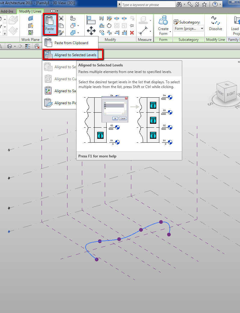

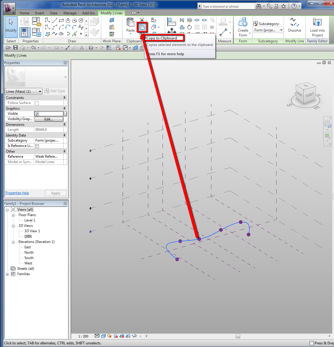

Just select the obj(s). then Copy and paste like you can see.

Correct me if I'm wrong, but that only works with levels.
See attached screen dump.
I've drawn my profile on reference plane 1, and want to copy it to reference planes 2 and 3 (to create a form from).
If I copy and paste, it places the spline back on refernce plane 1 even if I have another plane selected...

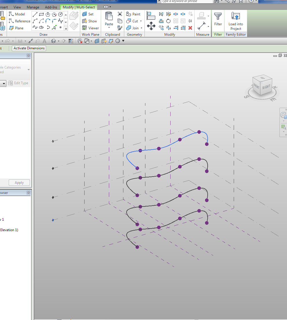

Of course you can, just watch the video: http://screencast.com/t/x71DeRd76U

Thanks for that (I like the music - does this mean that all answers in this forum will come with music?? I like that idea!)
The problem with that method is that it does not put the spline  on the ref plane (as far as I can see).
If you copy the spline as you have shown, and then move the Ref planes, the original spline moves with the ref plane, whereas the copy does not move with the ref plane its been copied to.

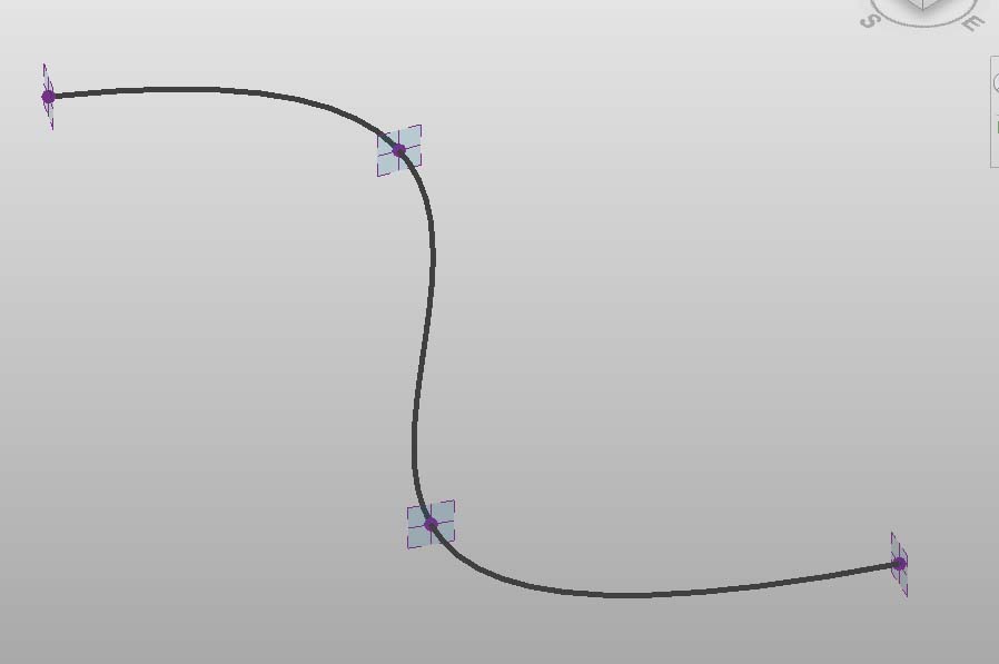

Also, how would you use that method if the ref planes are not paralell - say planes along a spline (see attached).
What I'm actually trying to do is model a form which will move with the spline, but I'm a little fed up having to redraw the profile on each plane (as its taking me ages) - which is why I'm thinking there has got to be a easier way of creating the spline on each plane.
I would like to copy the profile to each plane which I would then adjust.

"The problem with that method is that it does not put the spline  on the ref plane (as far as I can see).If you copy the spline as you have shown, and then move the Ref planes, the original spline moves with the ref plane, whereas the copy does not move with the ref plane its been copied to." - That's why you have the "Align" tool, select the ref. plane then select the profile then lock that blue "padlock".
About the rest, it's ANOTHER question, I think, first, you shoud take a look here: http://buildz.blogspot.com/
