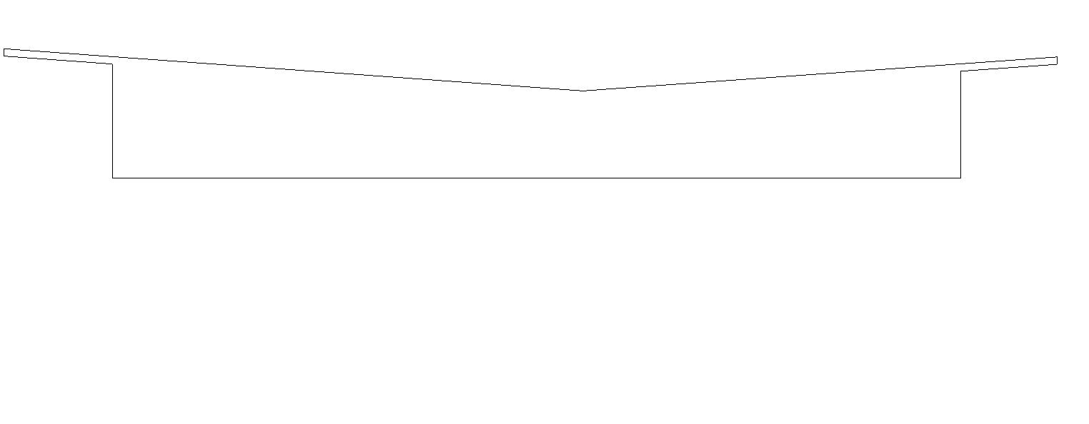

How do I make a roof profile as shown on the attached? Roof by Extrusion will not allow a closed loop.
I made the top chord with extrusion and vertical openings. But that won't work with the depth as shown, because I need the heel height to follow the wall jogs.

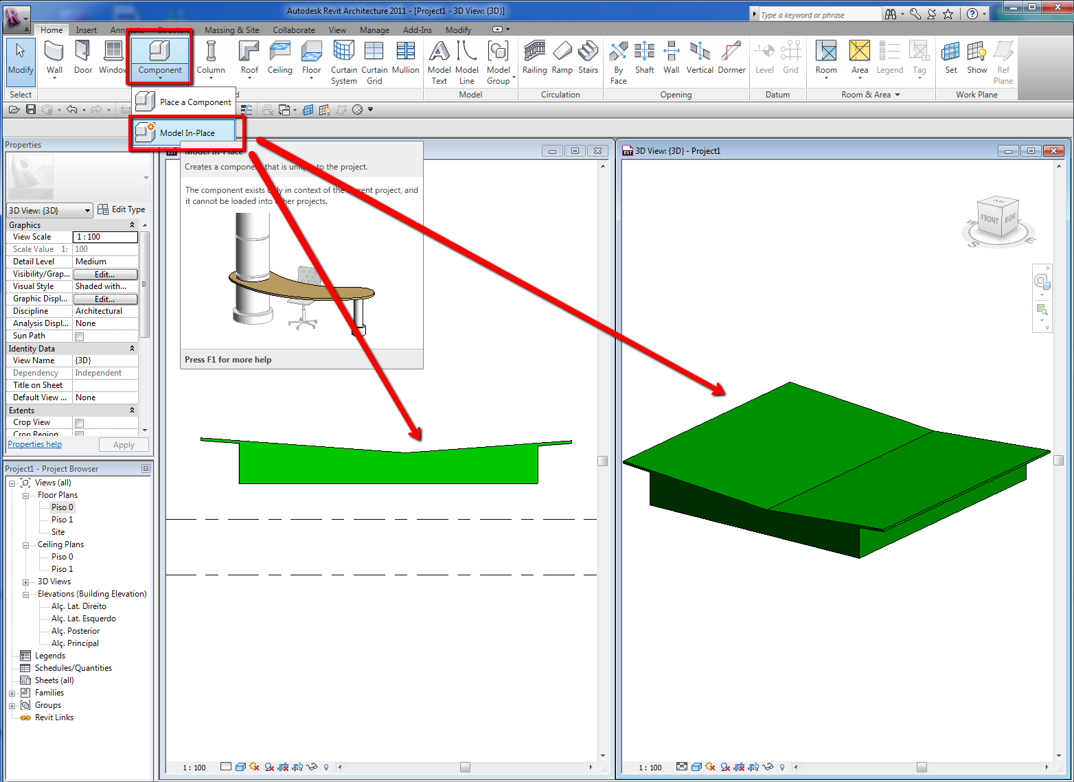

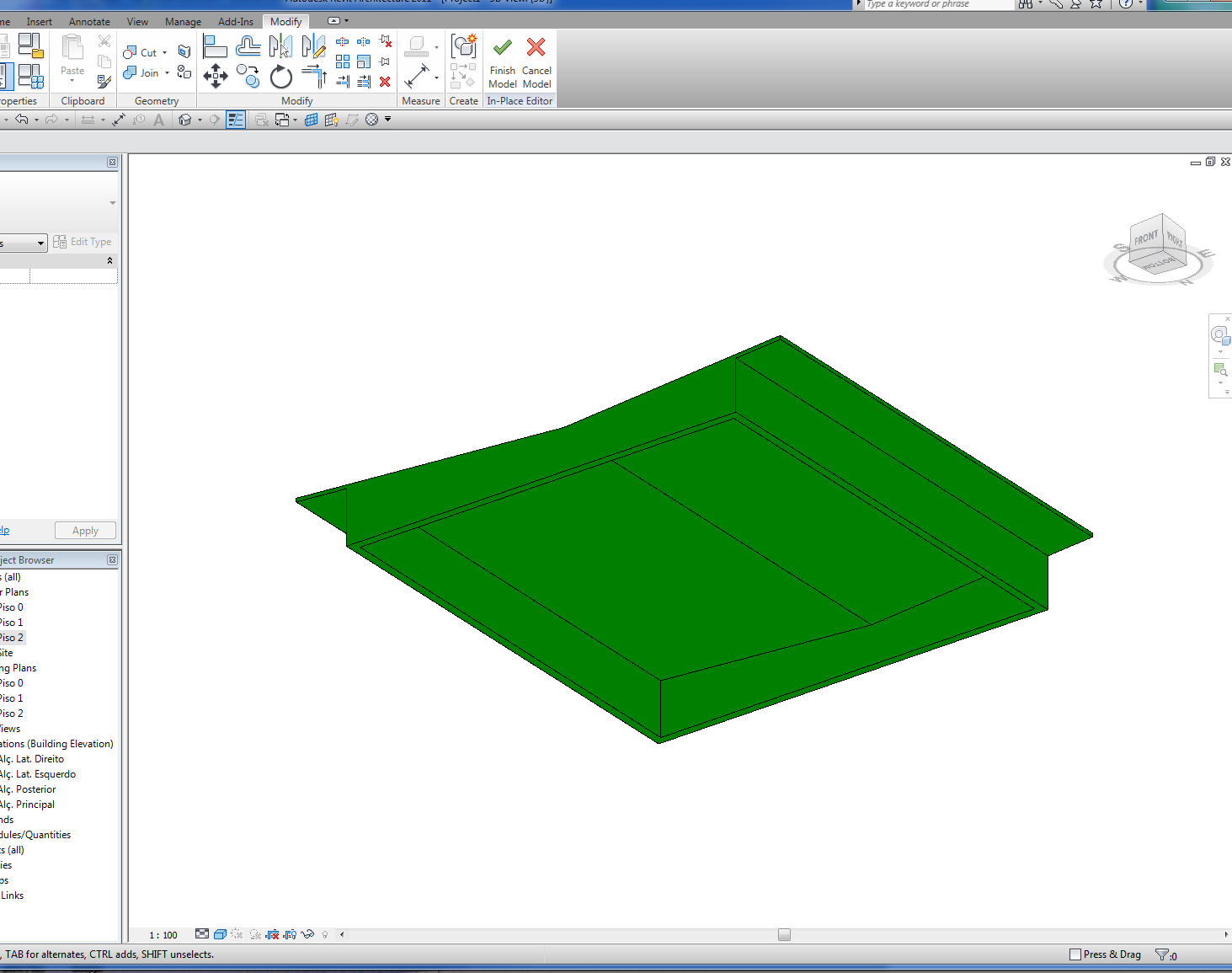

use the Create "In-Place" category "Roof"
Watch the video: http://screencast.com/t/DdOqeBEVk
