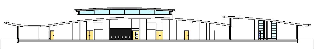

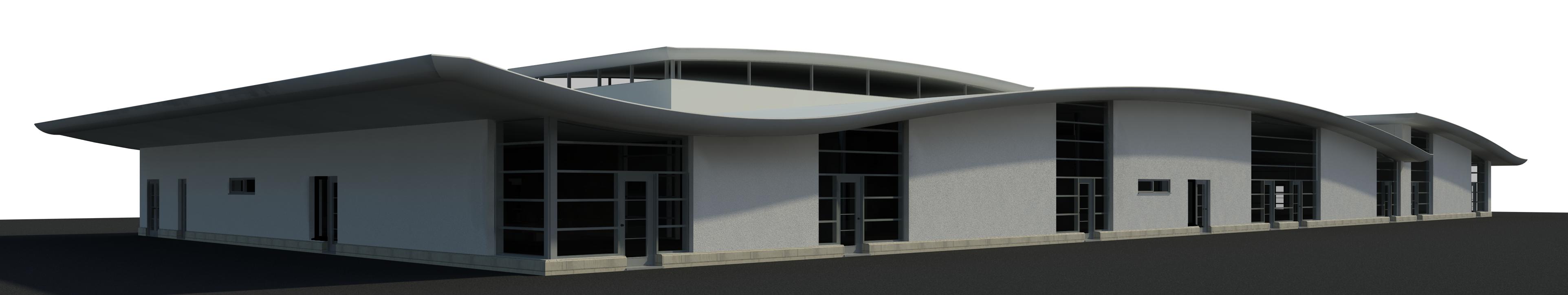

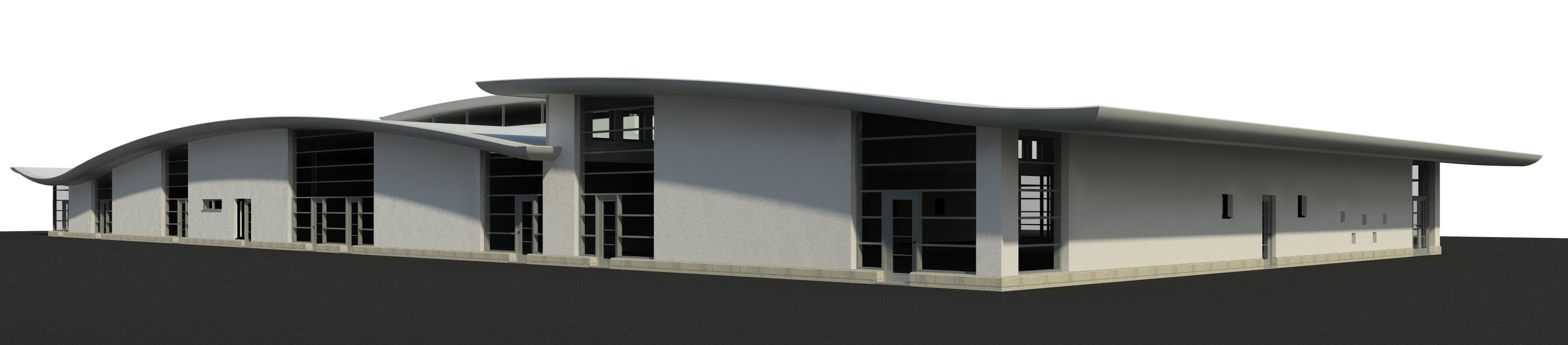

 I am using Revit 2010 and I am working up a model for a school extension we are doing in the office here.
The existing school has a curved roof and we are basically extending that out and gutting out the internals.
The Archichitect wants the ceiling in the classrooms and activity space to be 500mm below the roof line and following the curve. Hopefully the attched external renders are clear enough.
 I had thought of creating a secondary roof below the main one and giving it a ceiling thickness and material, hosting of lights i can work around.I am trying to do everything in Revit including Scheduling so I would like a way to be able to schedule the ceiling.
Thanks in advance

Create an "In-Place" family with the category "Ceiling"

Cheers Mate
That was perfect, I done an extrusion across the whole roof and then used void extrusion to cut out the weird shape rooms that did not require the full height curved ceiling. Worked a treat

hey mate,
just wondering what texture/material you've used for your exterior walls? Looks very realistic! Maybe it's the settings you've used?
