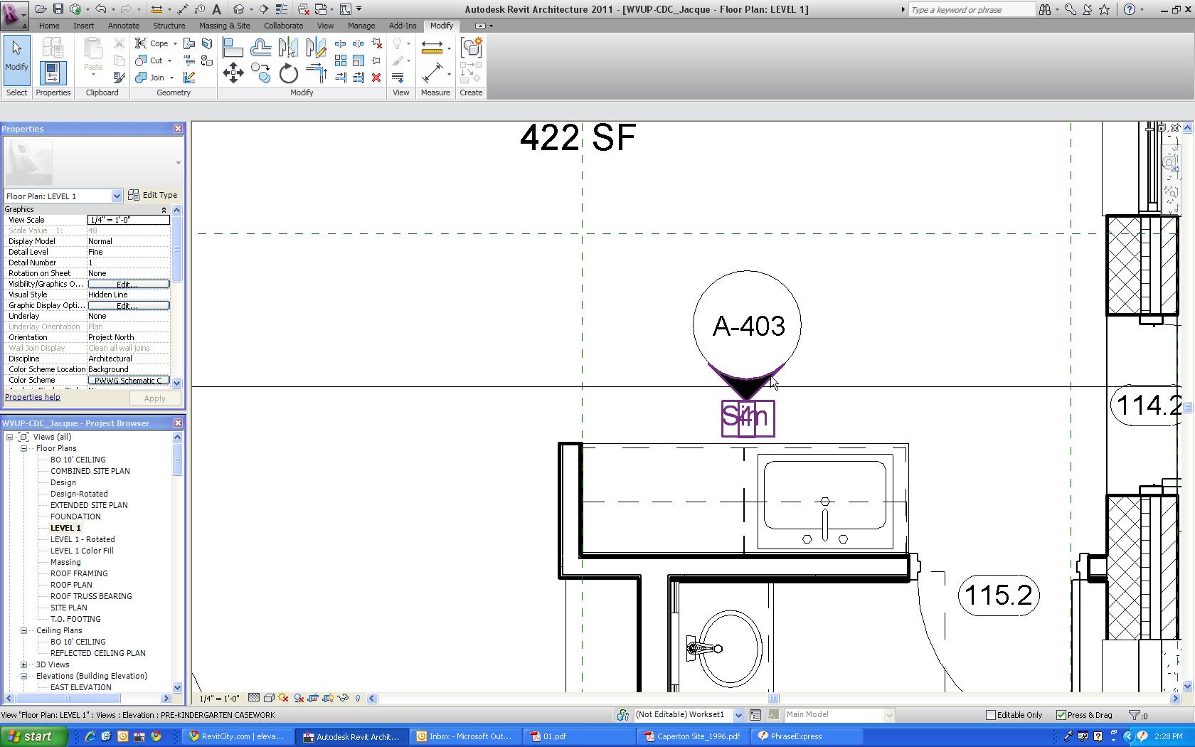

I have a problem with the interior elevation marker to note similar elevations. The "Sim" covers up the number of the view.  How do I move the SIM over?  I looked in the "callout tag" rfa file, but it looks nothing like the filled arrow I have on my drawing, and the SIM is far to the right of the circle.  ideas??

show view on this site, maybe larger scale will help.
Wed, Jan 26, 2011 at 1:13:34 PM | elevation SIM
You will have to edit the family and move the sim location

where is the family?  all I can find is "callout tag"  it says it uses 'callout tag 1/8" radius' in the properties dialogue
