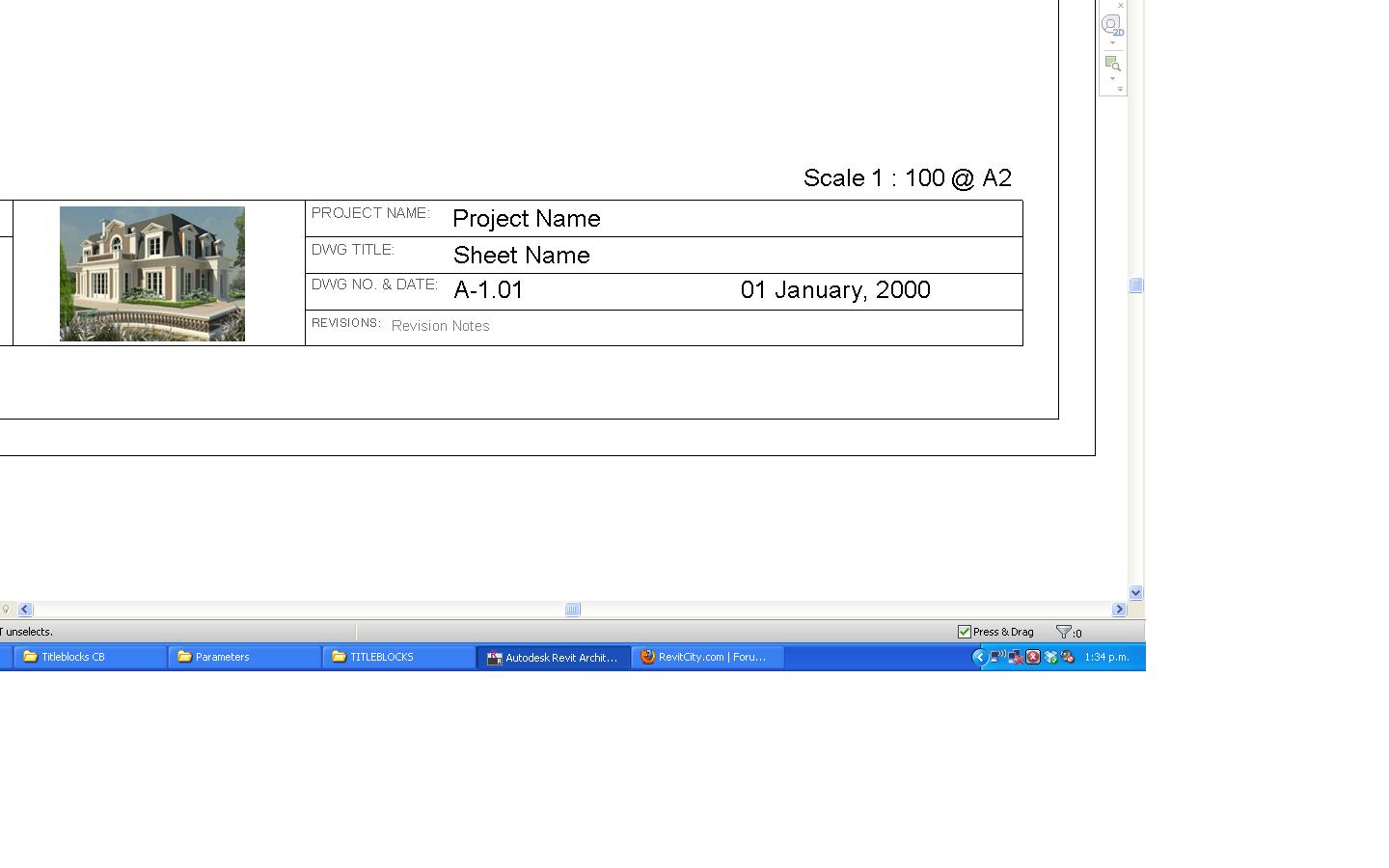

Hi there - I've arranged my title block to have an image of the building in it. This is fine on screen, both in the family and in the project, but it never prints. It's a jpeg image, nothing special about the file type etc, but I want to embed it so that for each sheet it shows up. I've looked on a number of forums but haven't managed to print it yet - any ideas?? Thanks
PS The attachment shows the image in the family, it prints everything but the image.......

i had the same problem until i printed as a raster rather than a vector, under your revit printing settings..  if embeding is what you want you would need to some how save it as a dwg and then place it in a drafting view, then place it on your sheet. if you need it on multiple sheets you would need to make it a legend view.  another printing issue is to print as an image, this setting is under your printer or plotter settings.
hope it helps.

My company has an image in it's title block, and it's a TIFF file not a JPG. Try changing the format of your image and see if that helps.
