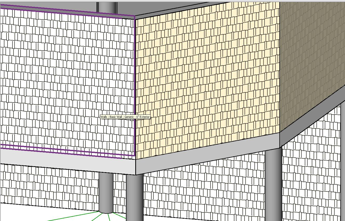

I was recently working on an octagonal home project and the exterior walls are using the cedar shingle hatch. The wierd thing is that half the walls look right, and the other half are upside-down, in an every other wall way. Any ideas what may be causing this? Using RAC2011.

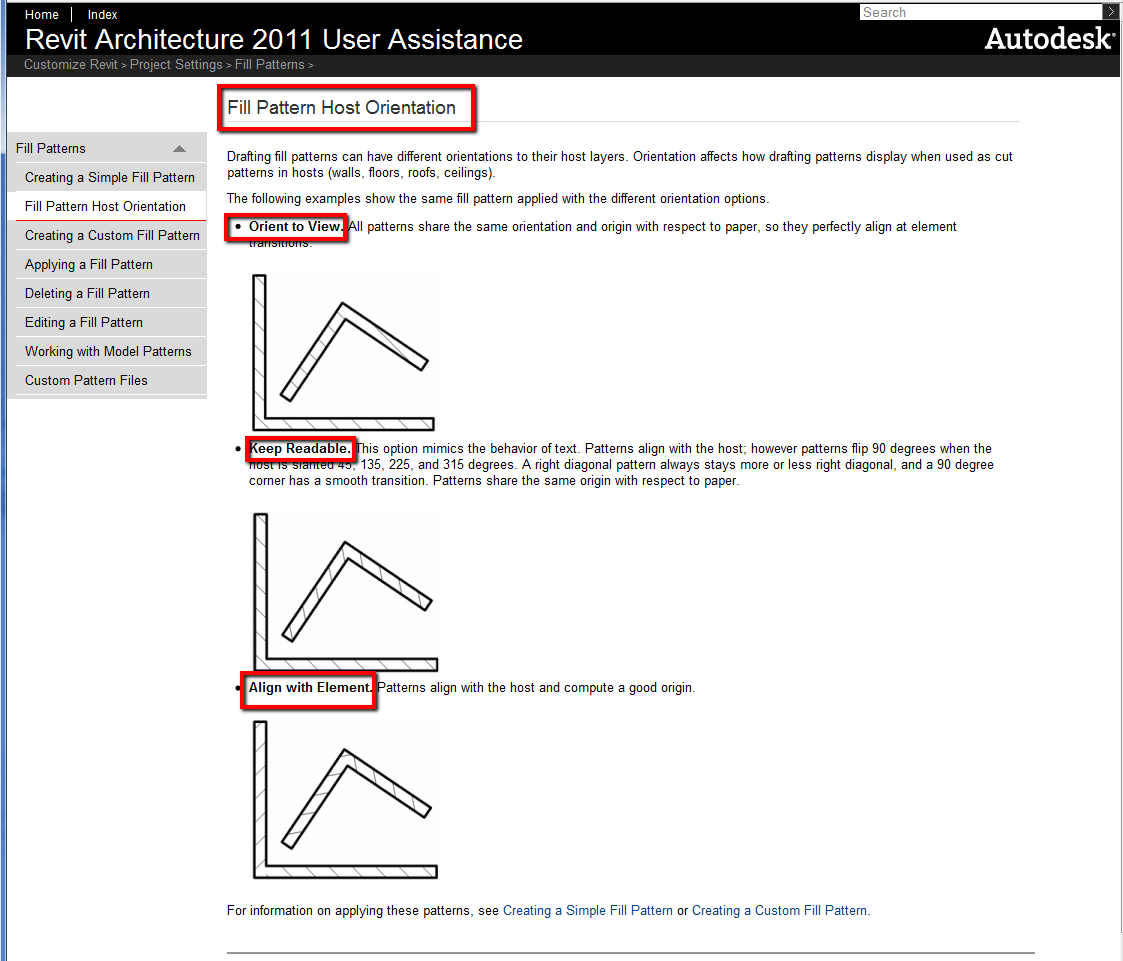

Here you have your answer from the HELP menu.

I appreciate the help, but it's not a drafting fill pattern, it's a model surface pattern on the face of a wall. I can't seem to find a way to orient it in the correct direction. I've attached a photo to make it more clear.

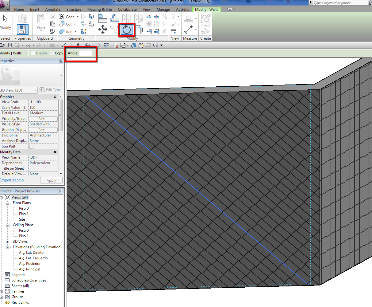

If that's a Model pattern just hover over one line in that wall then use the TAB key to select the line, then use the rotate tool and put 180 in your angle.
