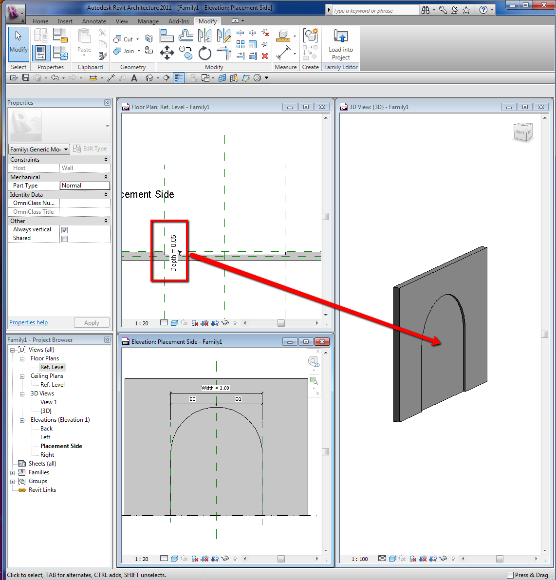

If this is a face based or wall based component, you should edit the family and add a void that cuts the host to the proper depth.
If this is a non-hosted family, you can create a face-based, paremetric family that cuts it's host with a variable size and depth.  It could be usable in many different applications.

Something like this?

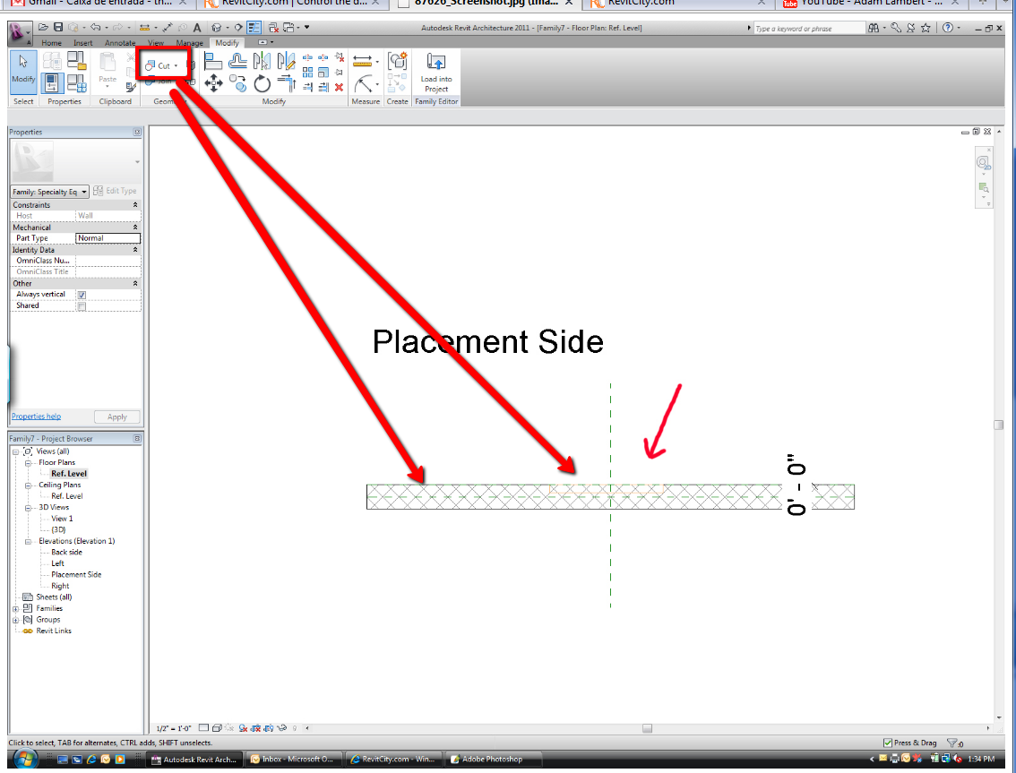

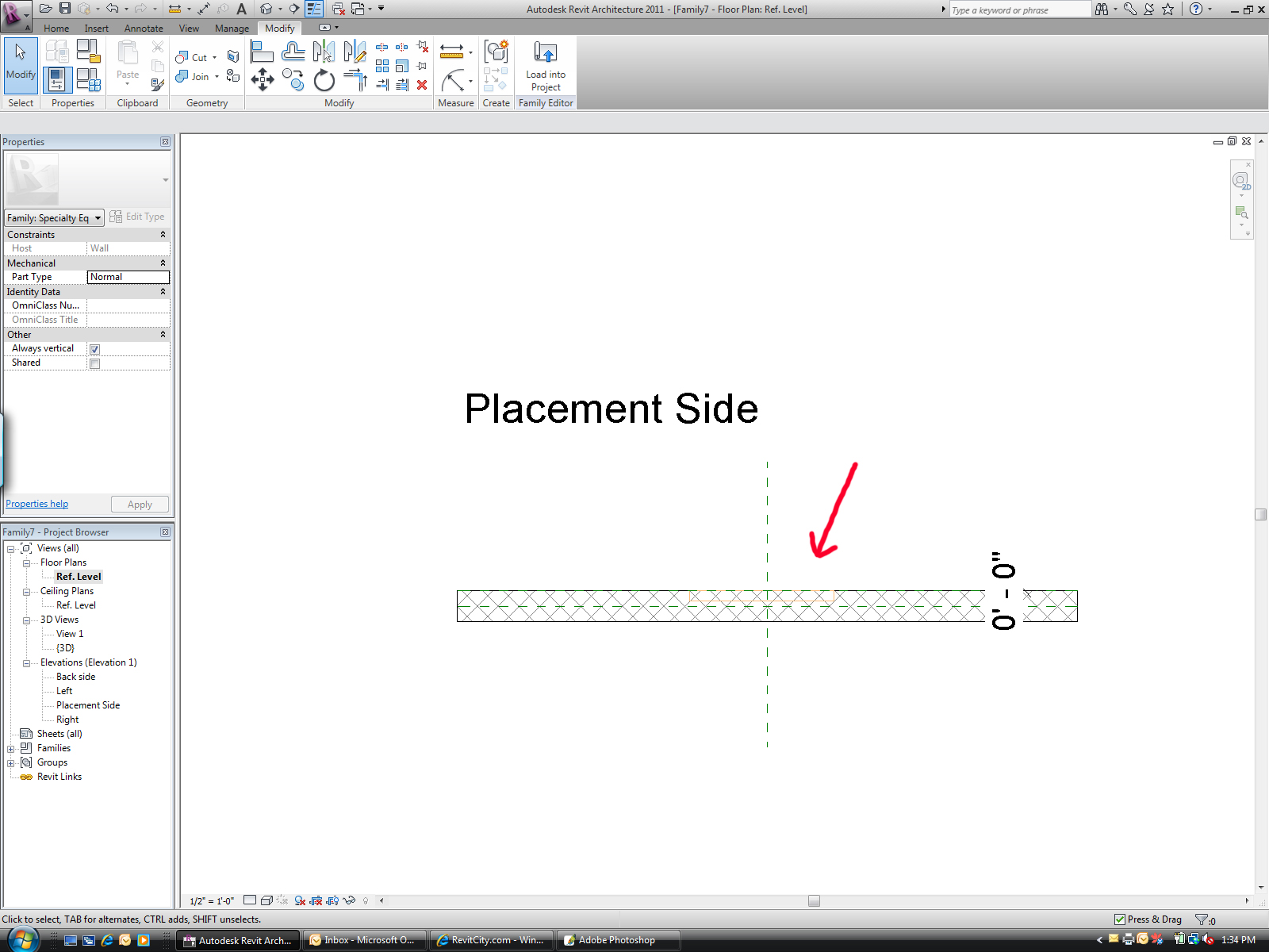

Okay, here is the problem I have run into: I am trying to create a specialty equipment - wall hosted component and can create a void extrusion, but it will not cut the default wall included in the family type. It shows up as a yellow transparent mass that is in the wall, but it does not cut the wall. So, how do I specify that the void should "cut the host"? I don't see any commands like this anywhere. Can you tell me where I can find this?

did you saw the video? I don't think so....
Select the "Cut Geometry" tool then select the void then the wall.

Yes, I just found it before you replied. Thank you SO MUCH for all the help! =D

Jason,
See attached family.
It is a parametric family can you can control the depth of the opening
Se your depth (wall depth) to whatever depth you desired
