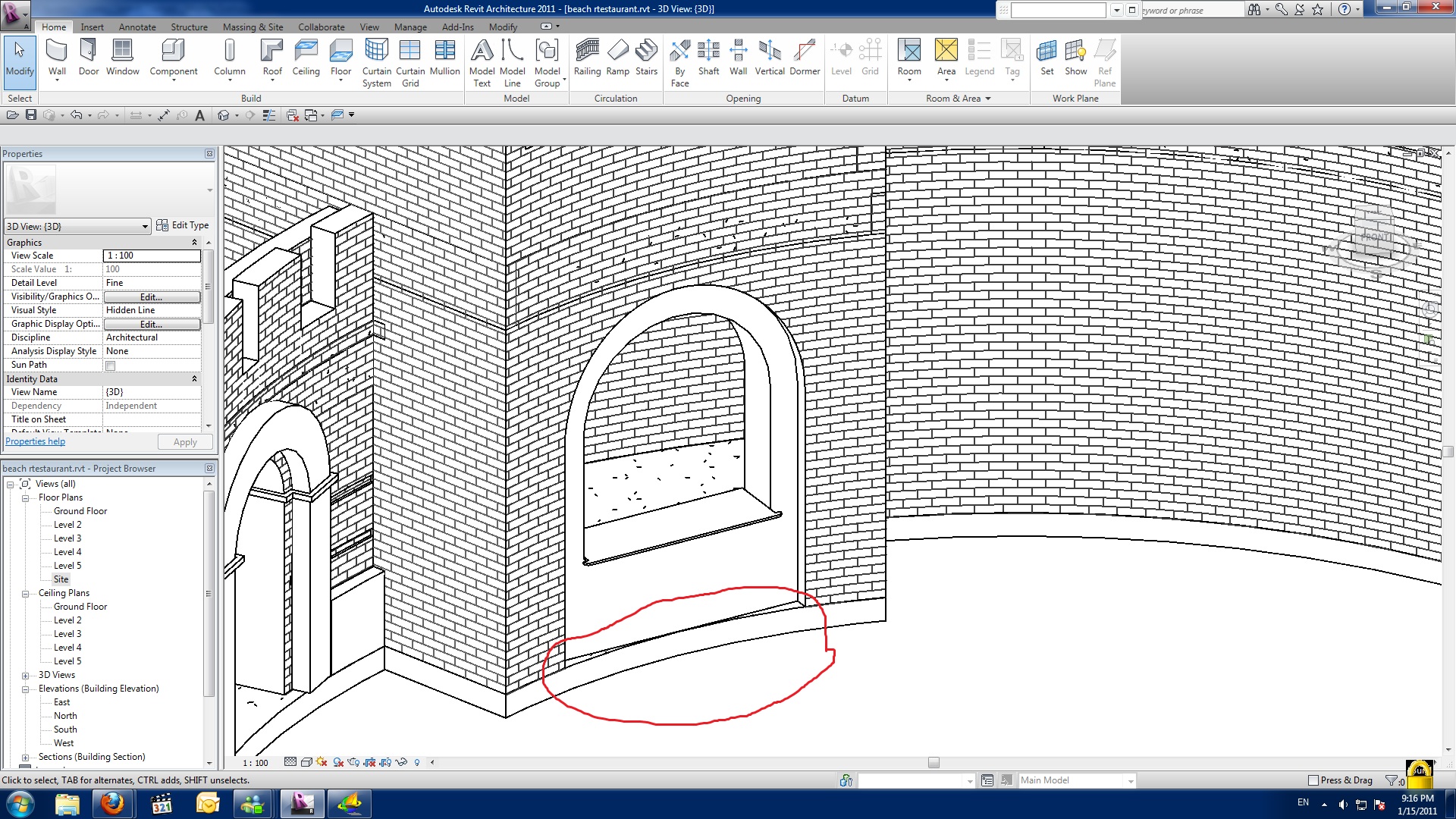

Dear all Guys,I can't make a recess in the wall to be curved the same as the original wall.what i did in the attached photo, is a Family , void object cut in the wall to form arched opening,but the result is what you see , any ideas

Just do an in-place void family.
